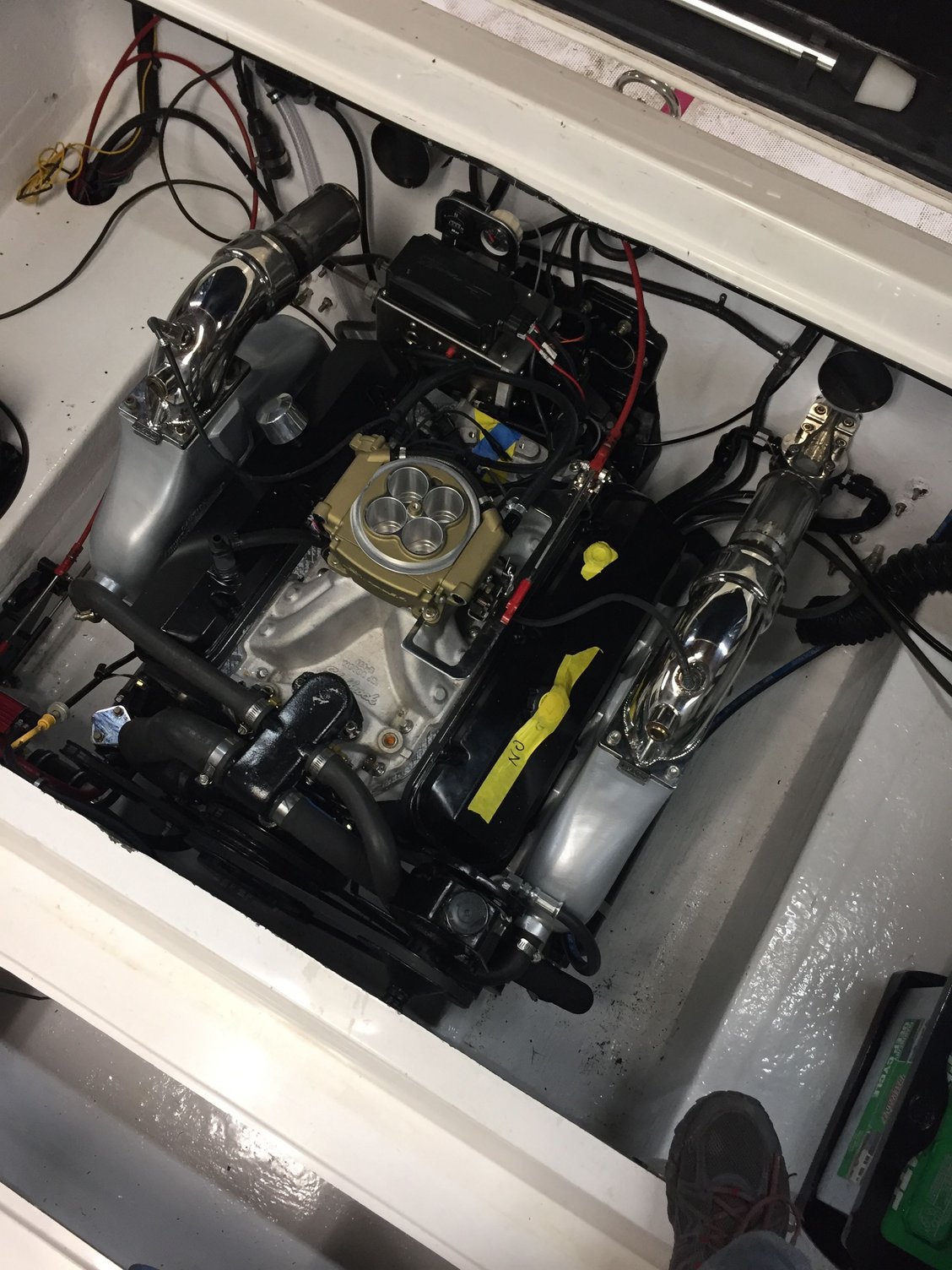

Not a blower motor but did add it to my rebuilt 502, have 18 hrs and seems to be running fine,
