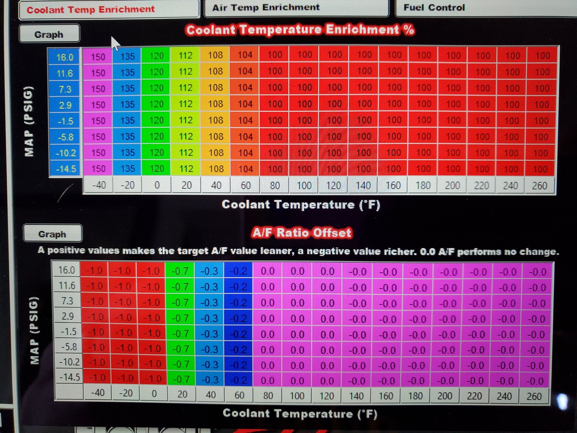

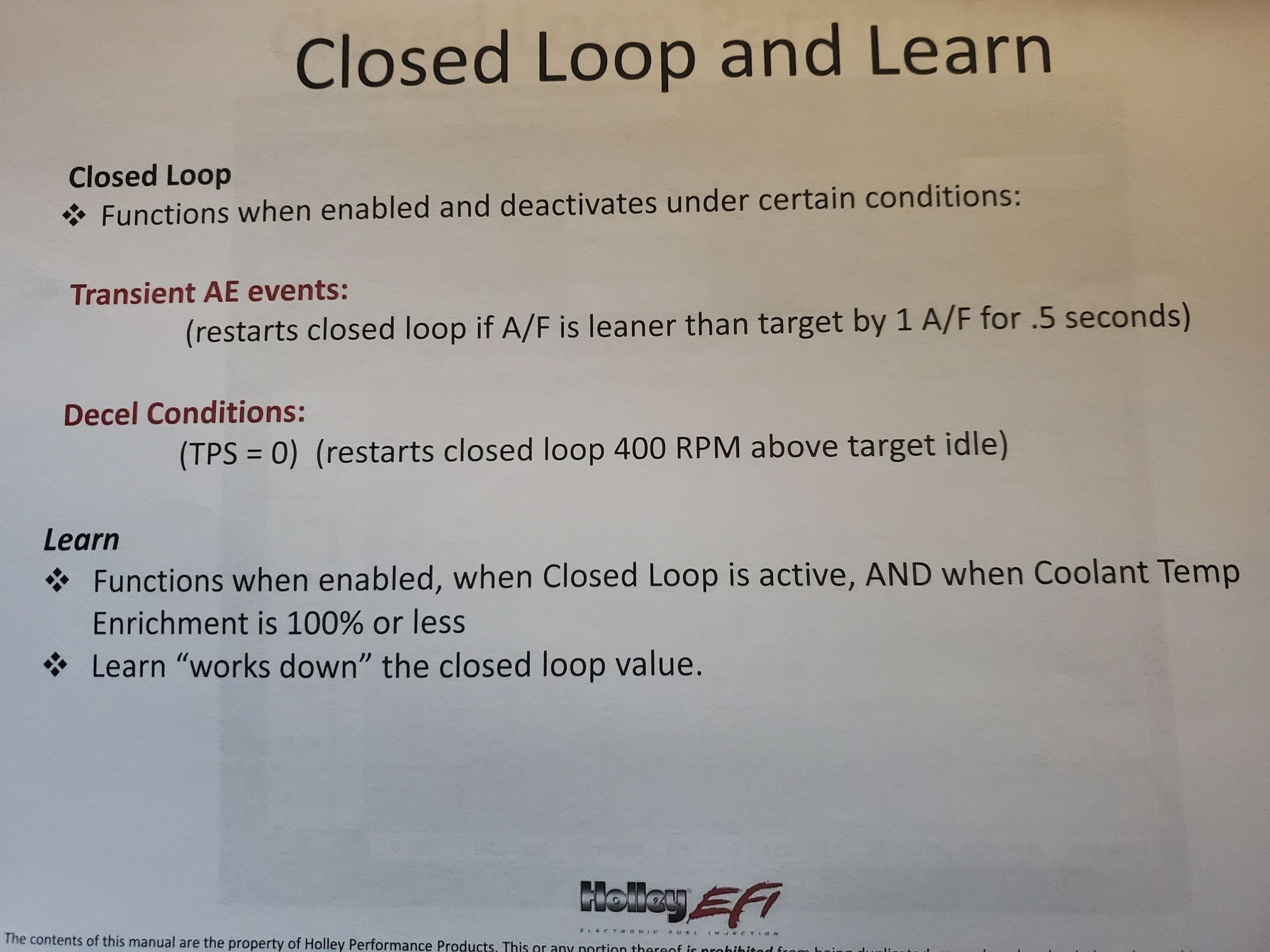

Thor39 04-01-2020 12:12 PM
Originally Posted by kvogt (Post 4731735)
On the HP and Dominator systems, yes your learn goes active when the coolant temp enrichment is 100%. Remember the system interpolates between table values so if you have 120% at 80 degrees and 100% at 100 degrees and your engine temps drop below 100 degrees the learning will shut off.
I run in Lake Michigan with no thermostat. My water temps run right around a 100 degrees and I use closed loop and learn while running.
Thank you! This helps a lot. Excited to play with this. So all I have to do is go to my coolant enrichment table/graph tool and position 100% enrichment at a lower temp and learn will then kick in? I will experiment to make sure this is true so don't feel like you're being held responsible here, LOL, but just wondering on the process. Thanks again, very helpful.
ICDEDPPL 04-01-2020 12:34 PM
That`s not my actual tune just pulled up the software on my PC
I never see more than 110* and learn is what actually screwed us up for idle tuning so as far as I know learn works at any temp.
My compensation limits are set at 15% . I monitor those and if I start to see them getting closer to 15% (usually around 5% unless it`s a cold start) then I`ll know my 02`s are going to $hit.
Either way not having a stat has not affected anything and learn kicks in right away even at 50* temps, no thermostat necessary
ICDEDPPL 04-01-2020 12:46 PM
https://cimg9.ibsrv.net/gimg/www.off...3fb64e6d43.jpg
https://cimg4.ibsrv.net/gimg/www.off...e21c7819de.jpg
Like Kris said .. (no temp requirement)
I don`t think I gave that table a whole lot of thought .. I believe that was a base tune from Haxby.
Thor39 04-01-2020 01:01 PM
Well, that's a bit different than what the manuals say for the Sniper. Maybe they assume the Sniper is more aimed at non-professional tuner users.
From my brief research, it looks like if I turn the Enrichment to 100% at X temp and turn the A/F Ratio Offset to 0 at X temp, it will then enter learn mode at that X temp. Definitely something to utilize for a marine application.
*EDIT*
Just wanted to add, I appreciate the input! This has helped a lot already.

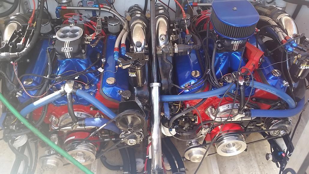

Rookie 04-01-2020 10:24 PM
If you are not using the Sniper for your dash you could run a resistor and trick the computer into thinking it's at 160°F when it is more like 120°F. Did this with the Fast EZ efi system when running a 140°F thermostat.

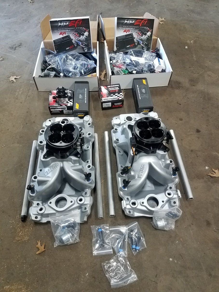

I'm going to be installing my Holley HP systems soon. Probably going to be asking questions here shortly. I am new to this system.
https://cimg4.ibsrv.net/gimg/www.off...6470fe7c80.jpg
B85 04-01-2020 10:41 PM
Good time to start a fight. LOL Wet or dry,TBI or Runner injector ?
I have all the N/A 840 BG stuff with a Victor Jr . So I don't really need to have a new manifold,but ?

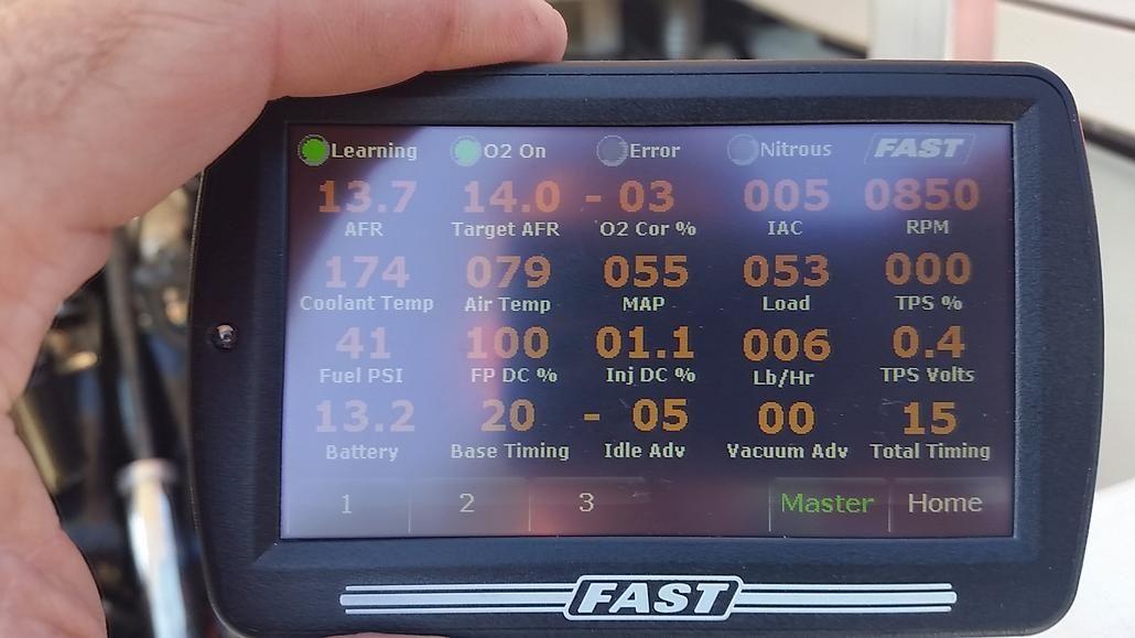

Valako (JimV) has been running the Fast EZ EFI 2.0 system on a customers/his new boat since 2014. Pretty nice system and very user friendly. Keep the O2s dry with the extensions and it has been very relaiable.
https://cimg3.ibsrv.net/gimg/www.off...16485ab1c3.jpg
https://cimg4.ibsrv.net/gimg/www.off...dcba161765.jpg
