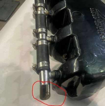

Originally Posted by Mbam
O - now I see. It wouldn't hurt to pull the fitting and have someone machine a section to give you a lip. We do that all the time when we make fittings.
I will probably.

Resurrecting and old thread...the same (starboard, outboard) cooling hose (starboard thermostat to exhaust manifold) popped off again today during a speed run.
I tried double hose clamps, but I believe that I really do not have enough pipe to get the second hose clamp to bite (So it probably put additional pressure on the one "good" hose clamp.
This time, I roughed up the metal with sandpaper and the used Permatex Black Gasket sealer and a hose clamp.
I am surprised that (with all these ~28 hose clamps on two motors) only this one seems to be giving me issues???
Does anyone have a link to a wider/stronger/upgrade for this hose clamp?

It looks like somebody possibly welded an an extension onto the end of that T. They normally have a lip on the end. I would have somebody weld a small ridge on the end
Griff is offline
The picture is not of mine exactly but is a pretty good representative of what I have...I will consider this action. Thanks!

What kind of water pressure are you running ? to blow hoses off
I do not know (no gauge, but I probably should have one) BUT two engines, two exhaust manifolds per motor and only this one has blown off...so I am thinking there is something unique/different about this side of the starboard engine.
