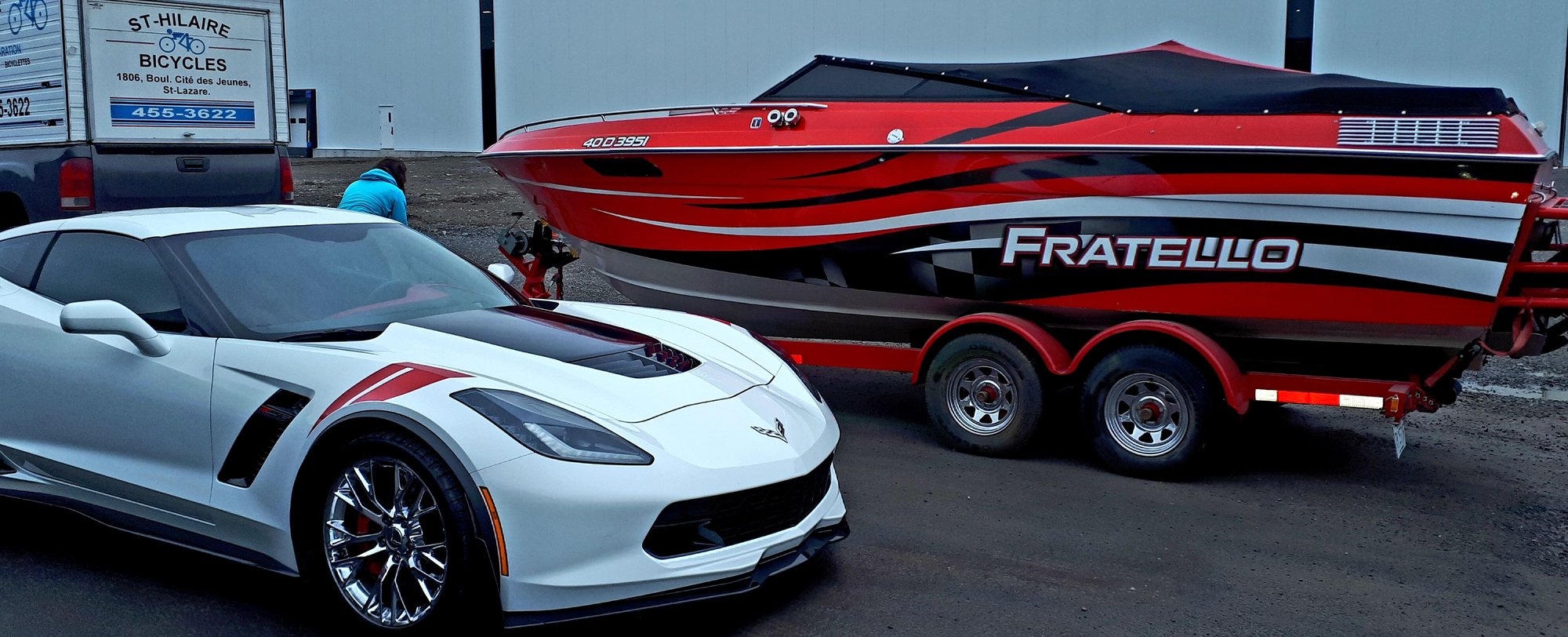

Hi everyone. I bought a 1988 Nova XL 3 years ago. It's a good looking boat and great fun for our family. My "guy" issue with this boat is its top speed of 38 knots @4200rpm. I was thinking it should be more like 45 knots. It has a 454 330hp, quadrajet carb with Bravo 1 and a 23 pitch mirage prop. There is a 1/2" side to side looseness in the Bravo which I think by its age could use an overhaul and new pin to fix the loose. The carb is probably original and maybe affecting top performance. What top speed should I really be getting here, and what can I do to improve this? The basics are done, plugs , oils, filters, wires, coil, distributor, rotor..thanks

23 feet correct. The previous owner put Fratello instead of Nova XL as the brand for some disappointing reason. I have read around online it should be a 50mph boat. Unless the owners bump up the truth a bit....
