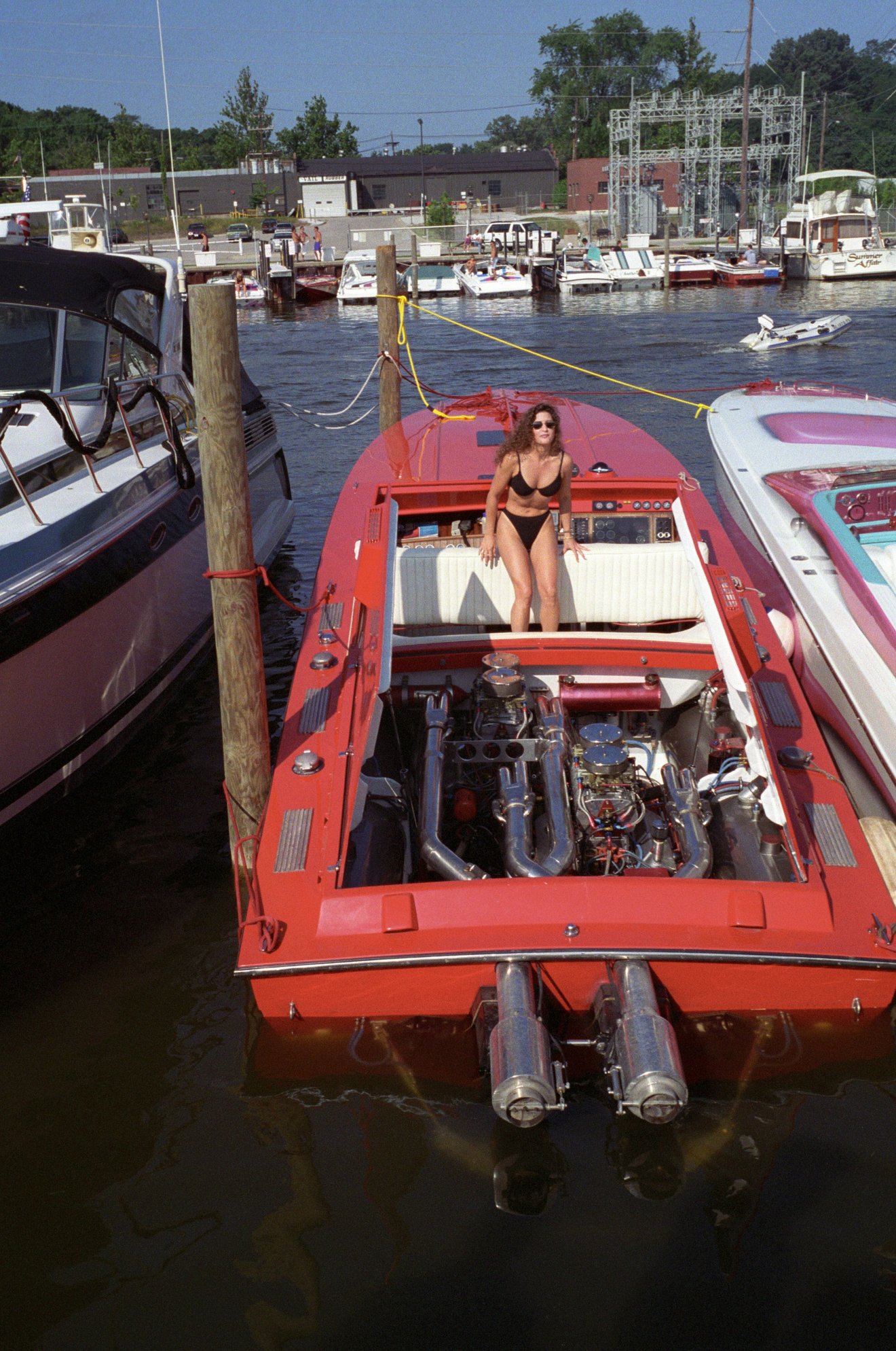

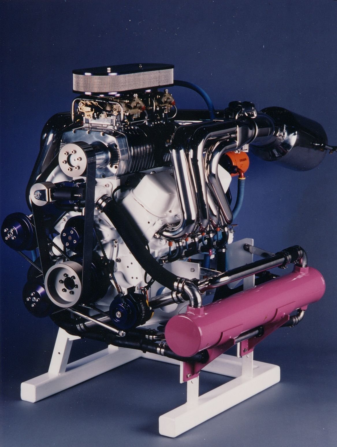

I first put closed cooling in my Cigarette back in the early 80's after losing my first set of heads to saltwater. I lived in Chicago at the time but the boat spent winters in Florida. Only had 800 hp at the time. To be honest I didn't do the math as far as sizing but put in the biggest heat exchangers I could fit (6" x 30" ) knowing I would wind up with more power. I mounted them in front of the rear engine.
The expansion tank is visible on the forward bulkhead. This pic is from early 90's when I had 1000 hp blower motors ps they ran on 89 octane. Water temp would hold at whatever the thermostat regardless of speed.
I'll see if I can find some better pictures.
The benefits of closed cooling are way more than the lack or corrosion:
  • Constant block pressure with glycol raises boiling point - helps control steam pockets
  • Constant block temp
  • Non aerated water in block removes heat better - see above
  • Unrestricted water flow through oil coolers and exhaust
Later in life I did some more projects, all closed cooled.
I still have a pair of big heat exchangers at the shop. I'll post some pictures tomorrow.

Great picture of a runaway dinghy navigating through the marina in the background......
Mbam 09-27-2020 09:43 AM
I think it was being towed lol
