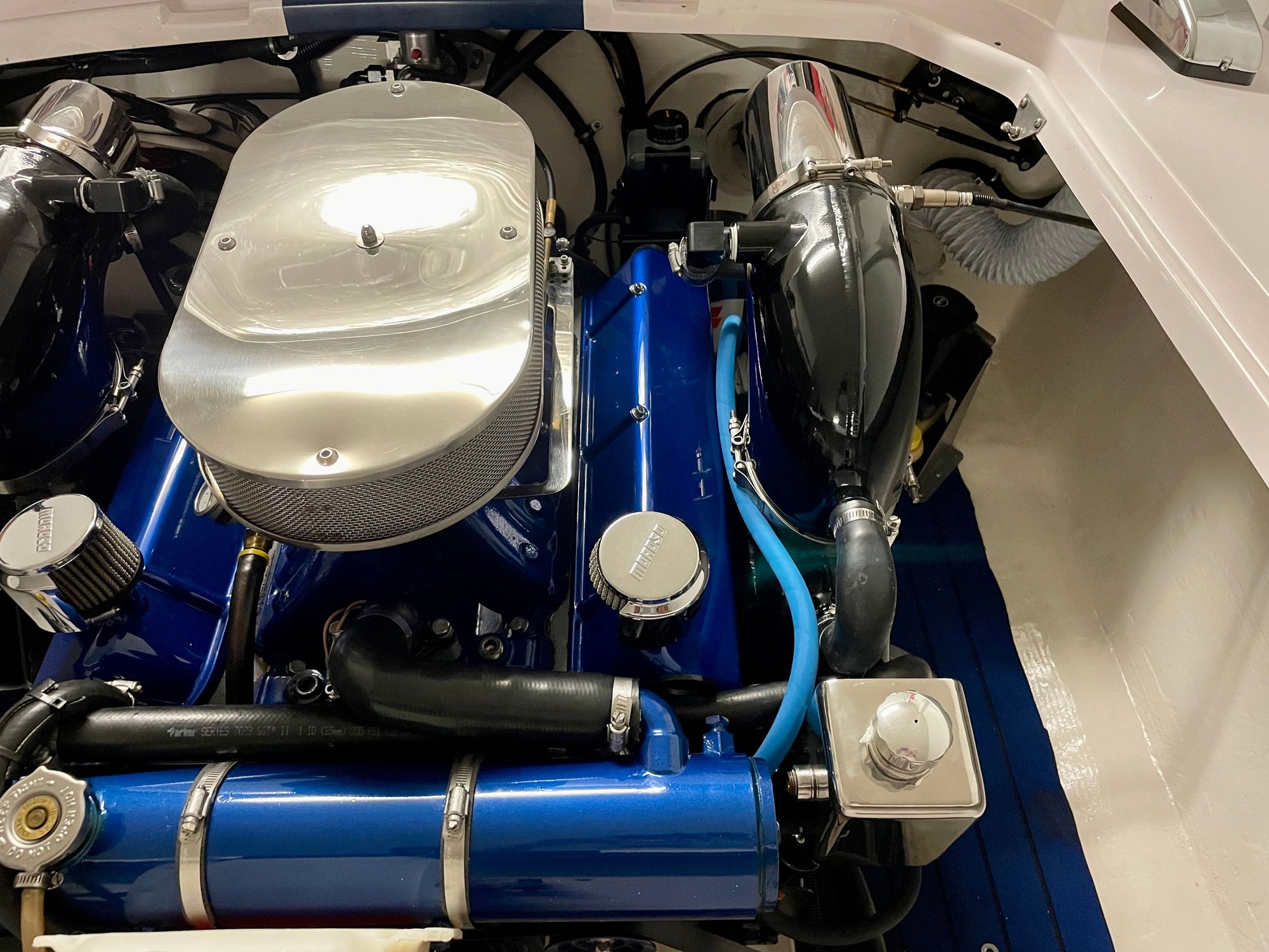

I am at a little over 700 hp and using a monitor pro setup when this was a mag mpi engine. Haven’t seen temps over 160 even running in 90+ degree water.

That's a really neat setup!.....Was it rigged new with engine install - or - added afterwards? - is it full closed cooling (engine & manifolds?) ....monitor I believe is backordered till spring ..

It was rigged out of the boat after the rebuild. It’s a half system.
