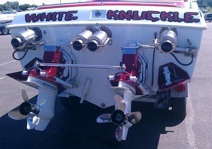

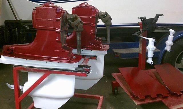

I single stage painted my tabs and drives in 2010 and they held up great. I have seen an instance that powder coat has came off in a sheet on a drive.
