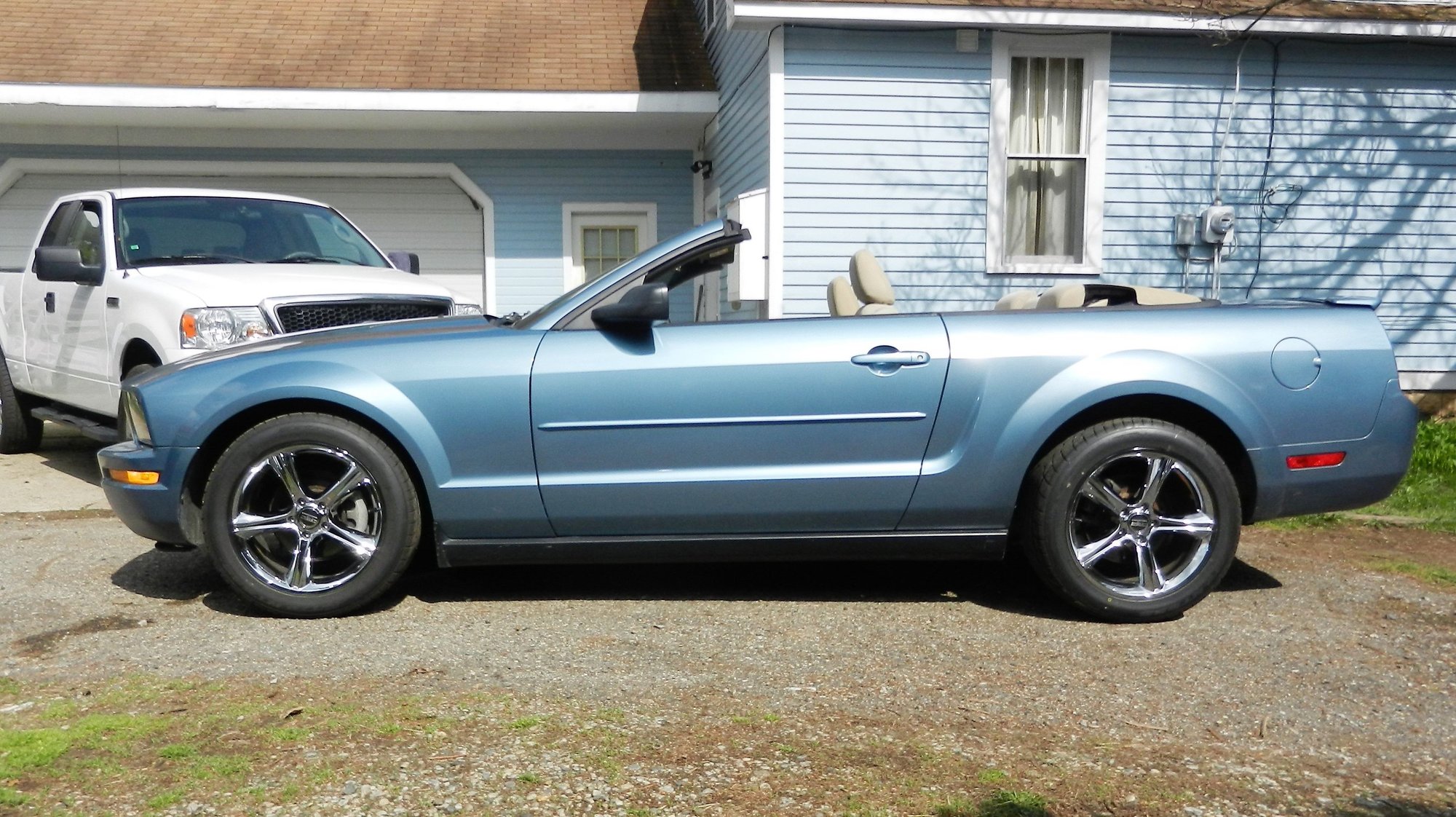

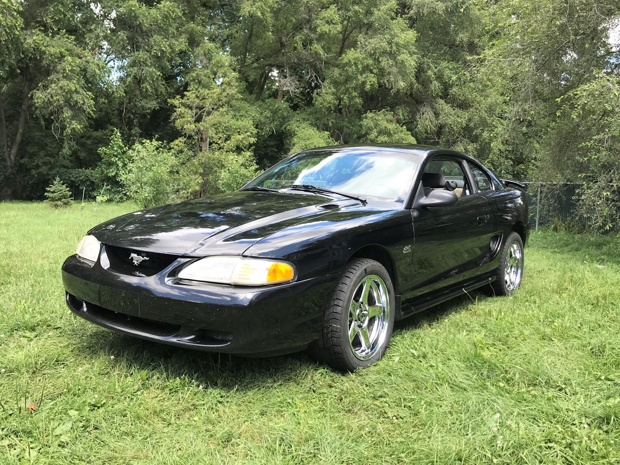

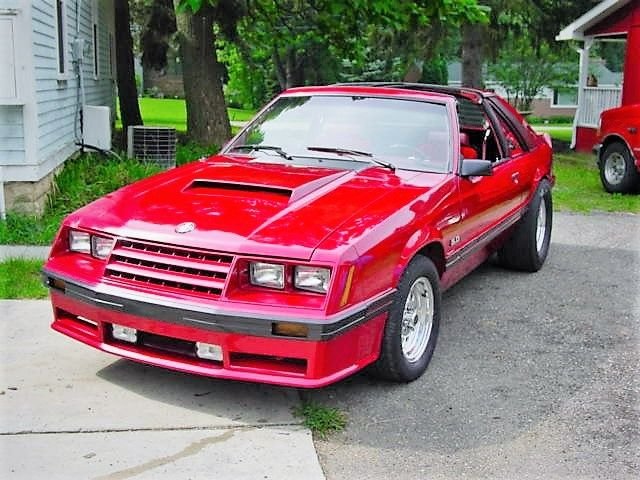

Lots of car enthusiasts here and I'm sure there are some other Ford fans. I own an '82 GT T-top that has been hot rodded but body is stock. It is scary fast running light but is old school and no match for the wilder stuff. Also a '95 GT (last year of the push-rod 5.0) and an '07 convertible. All are very nice and stored in the winter. I have owned in the past a '65 coupe, '66 fastback, '67 convertible and '68 coupe.

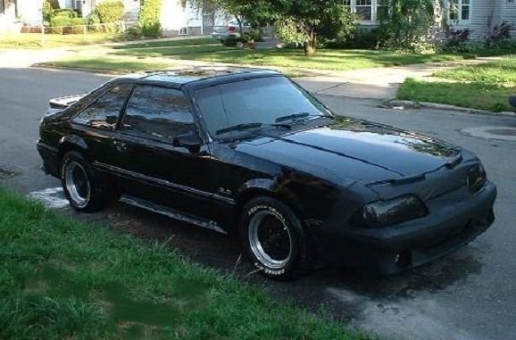

It's good to see some Ford fans here. I don't have any good pictures of my car. Most have a inch of dust on it. Been sitting for almost 3 years now with all the issues on the last build. I bought this 90
https://cimg4.ibsrv.net/gimg/www.off...334116d486.jpg
brand new back in 90. Been thru quite a few upgrades over the years. This is the only picture I have on my phone from a few months ago.

Nice! The Fox Mustangs are so light. Mine weighs 2,800 pounds. I've owned my '82 since 1984. Sorry about the sidetrack. Engine gurus come back please!
underpsi68 10-23-2020 04:24 PM
Mine is a pig!!! 3400lbs with me, with single turbo. New block heavier than last. She's a heavy girl. AOD w/sfi bell, back braced Strange 9" rear, 8 pt cage, full interior, big brakes all around.
