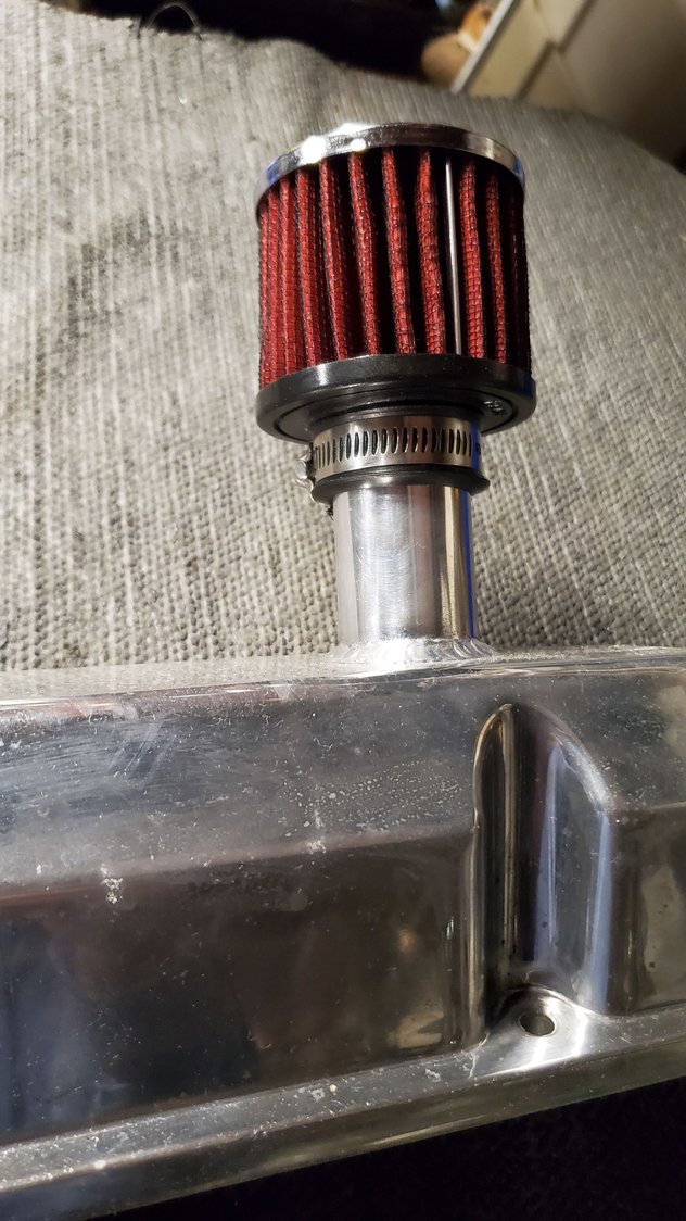

Had this happen on my 548 with K&N breathers. Felt like rings didn't seal and had excessive blow by and breathers were dripping with oil. Those filters directly on covers get oil mist soaked in them and quit being able to flow air. I changed to different and taller style and no issues after that.
Breathers are not right on valve cover. It was pushed down in picture. Off the top of my head the breather tubes welded on the valve covers are about 4" high(similair to the driver side). Plus a trick i do is cut a piece of a/c filter foam and roll up and put in tube. It has very large cells. Will catch any oil before it hits the breather element. It will drip back down. Did that on the working engine for 10 years.
I will look into breathers and put carb filters on each cover if needed. 😄

Gimme Fuel 10-22-2020 07:02 AM
Originally Posted by articfriends (Post 4762611)
I thought you also lost ring seal though from piston touching the cylinder head from not enough piston to head clearance at one point too at .027, was that the same motor? at same time, just curious.
No that was first attempt and had the gapless stainless rings and 0.27" gasket haha. Rebuilt with conventional AP rings and .039" head gasket and still had a WTF moment when running and questioned ring seal again. Changed breathers to tall stainless style, and no more issues all summer until slowly degrading oxygen sensor and left active auto-tune detonated a piston on last run of the year.

underpsi68 10-22-2020 07:22 PM
Originally Posted by SB (Post 4762747)
The biggest reasons turbos will smoke is poor drainage. The oil can not get out and the pressurized oil has no where to go except out the shaft. At that point it will either go in the compressor side (into intake) or in the exhaust system (not going directly into the engine).
Here is a better picture of my breather. 2" tube
https://cimg8.ibsrv.net/gimg/www.off...1d7da0bac1.jpg
