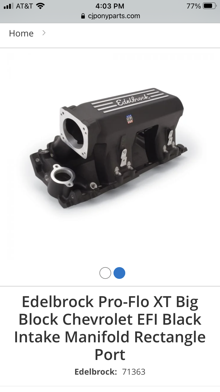

https://www.cjponyparts.com/media/ca...363_2.4856.jpg

That’s interesting.
