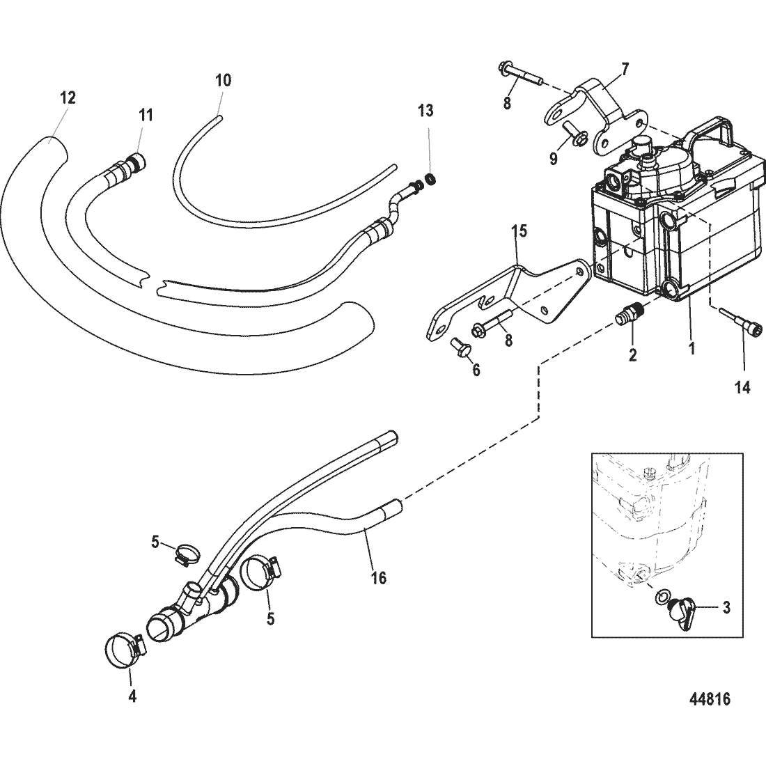

Now when I have the engine half apart im cleaning my injectors and looking at my cool fuel system to get it cleaned.
I have some question about the cool fuel system on my engine though.
I have heard about the paint problem in the cool fuel system like we talked about, and like I linked to a youtube video some posts before.
But when I look at my engine, my system isnt like the cool fuel system that the guy on the video has with the paint problem.
My cool fuel system looks like this one, and are located in a plastic box on port side of the engine. #2 and #25 in the picture:
The guy on the video has this one, what I believe is located on the starboard side of the engine?
And is called Gen III cool fuel system??
My questions is:
can I prevent something to happen, or clean my cool fuel system in some way?
Or is my cool fuel system better than the other one?
Is there anything that can go wrong with my cool fuel system?
Is it called Gen II cool fuel system?
If there is something that I can or must watch over with this type of cool fuel system please let me know!
Thanks!

My 2004 496HO had the older Cool Fuel 2 system, which didn't have the paint issue. The 2 system also has an adjustable fuel pressure regulator from the factory. It also does NOT use that internal filter the looks like a disc. Looks like you may have a Cool Fuel 2.
