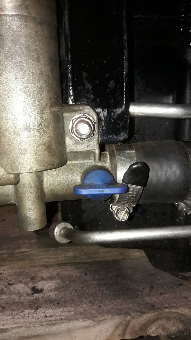

Have you used one of these plug holes to put the connector into the pump housing? (Blue plastic plugs; the pump has them too...)
What about this specific plug location, (the blue one in the picture) on the PT side water drain vent?
The water will have passed through the STB side, the back, the oil cooler and the PT side before coming to this point. I reckon this would enable me to monitor a greater route by attaching it here. What do you think? The pressure should drop more closer to the end of the loop if there's a leak somewhere, right?

Those blue plastic drain plugs have a funny thread and oring setup. I don't think you want to mess with trying to adapt that hole. Like was mentioned, you could T off your factory sending unit on the water pump, or if you have a 1/8" pipe thread drain on one of your coolers.
OK, Thanks! None of the coolers seem to have drain plugs, but maybe I can cut the hose somewhere and clamp on a t-fitting, or I'll go with the hole for the pressure sender. (The advantage of having the hose for the gauge as late as possible in the system would be that if something gets clogged somewhere and the pressure falls in som parts it would still be discovered, which I'm afraid it wouldn't if the pressure builds up right after the pump...)
