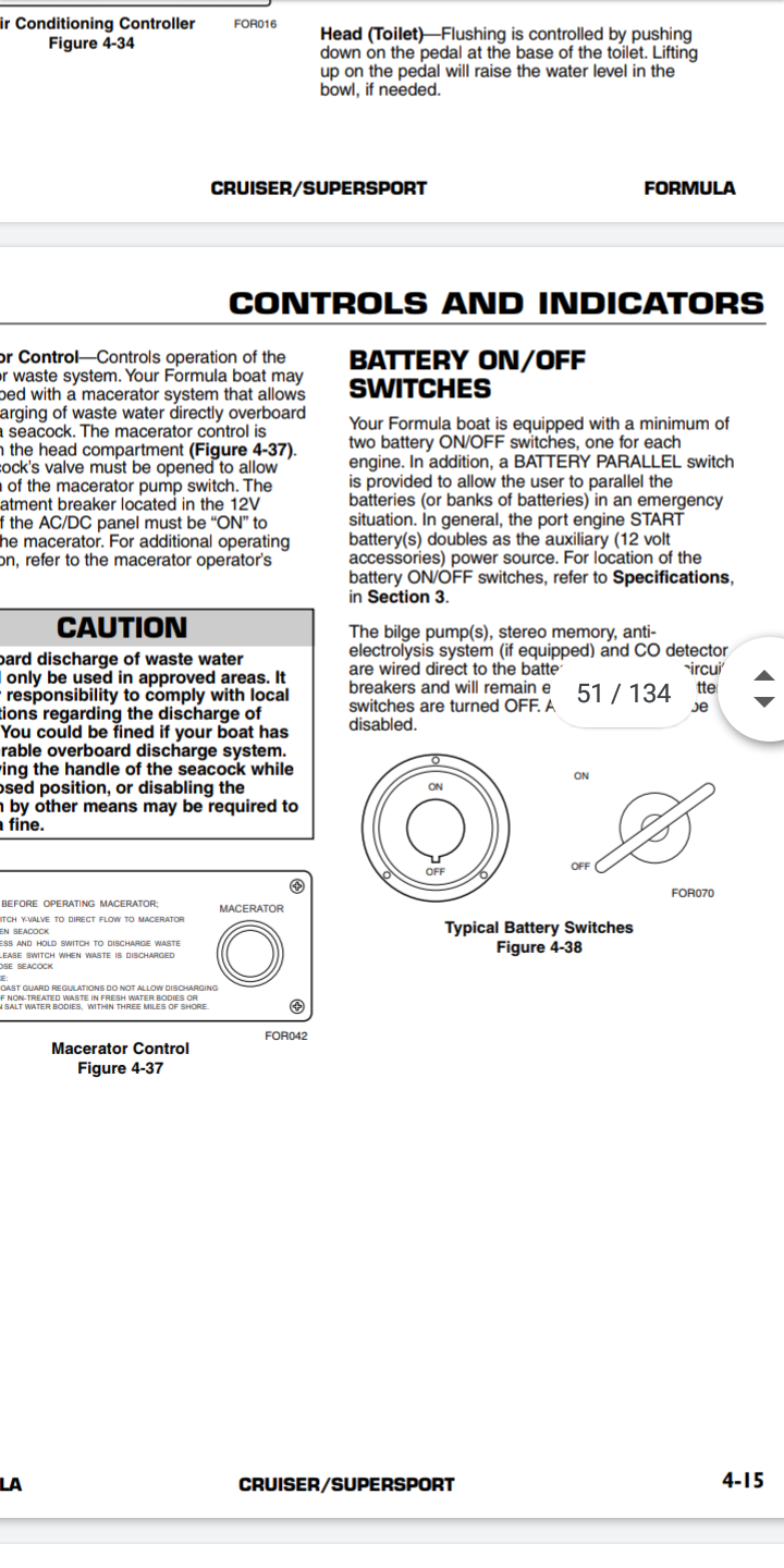

Since I can parallel them from the switch do I even need to parallel any of the batteries at all or parallel all three of them what's your advice

You can parallel as many bats as you like, the draw back is IF (big if) one of them has an issue, they all can be taken down by the bad one. If there happens to be a dead short, then there are all those other bats providing more heat and power to ground. Some put fuses between large banks just to protect against this.
With your setup I would connect the house with the stereo, unless you have things on the boat that you don't want to go dead like the fridge. Now if even when using the stereo if it doesn't kill the bats, then your still good
No, unless you need more power then your getting now

Your boat was designed to parallel the house and port battery by Formula. They figure if port doesn't start, you can start the starboard and then get the port started from the ALT off the starboard.

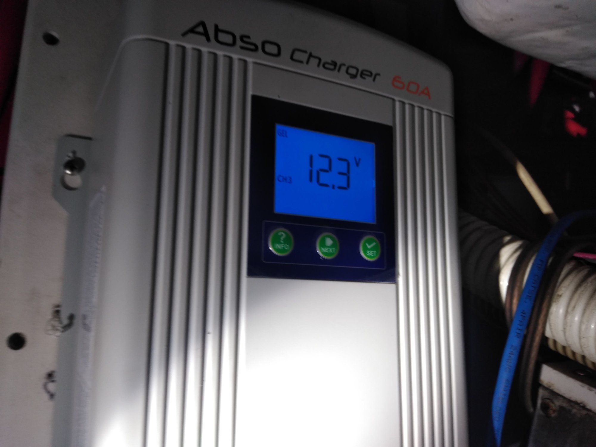

That is correct the three bank charger I believe it connects the two engines or charges to two engines and the stereo batteries there is no connection or lead to the house battery to keep it charged

You have 4 banks now,
port and house
starboard
Gen
Stereo
Maybe there is a ACR somewhere

What's an ace may I ask I will look for it

ACR is automatic charge relay, like this Blue Sea model
https://www.bluesea.com/products/761...12_24V_DC_120A
I connects between one of the banks and connects automatically once charging starts. It comes down to which bank is not being charged directly by Bat charger? Could be the Gen charges the Gen bat only when its running. That will work so log as it gets used, otherwise it will discharge far enough someday and go dead
