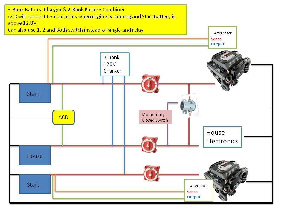

The good and bad of paralleling bats. Good is you get a larger bat for more cranking amps. The bad is if one shorts a cell, it will take the rest of them down with it. Do wonder why the stereo needs 2 bats and house just one. I would have thought using 2 bats for house and stereo, and even a 3rd with the house only if the load was to much. Or even better yet just use Lithium Ion bats and not worry about the load
Not actually seeing/measuring what you have I'll say this. Can have a great mechanic but may not be a great electrician. How is the charging accomplished when running and on shore power?
I like using a solenoid to momentary battery paralleling. The switch is at the helm, so if it won't start, press another button and the solenoid combines the bats. Start the motor and then release the button and your good to go.
