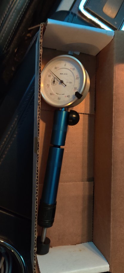

Thanks for checking in SB. To answer your questions:
1. You're asking how I zeroed the degree wheel right? I set the piston at TDC and rotated the wheel until my pointer was pointing at zero and locked it down. To set TDC, I first rocked the piston fully in one direction, measured it, divided by two and rocked it in the other direction by that amount. I set my dial gauge up in the center of the piston with my bridge at that point. For the sake of taking any issue with that method out, I'll use a piston stop today to get zero. Even if I was off a little, which I don't believe I was, it wouldn't have been 8 degrees.
2. My lobe lift tool is the Proform one. I attached a pic. I don't have the squared off attachment and my machinist buddy said last night that it's possible the hemispherical head is causing an issue if the ramp is too steep. He lent me his tool that I'll try today.
This isn't my first engine. I've built a few before and degreed cams. For some reason this one has me stumped.

One more thing to add. I took the holder and extension out of the equation also and installed the dial indicator directly in the lobe tool. Here is a pic and also one of the tool my buddy lent me.

Does that round foot mimic exactly the the roller wheel diameter of your lifters ?
