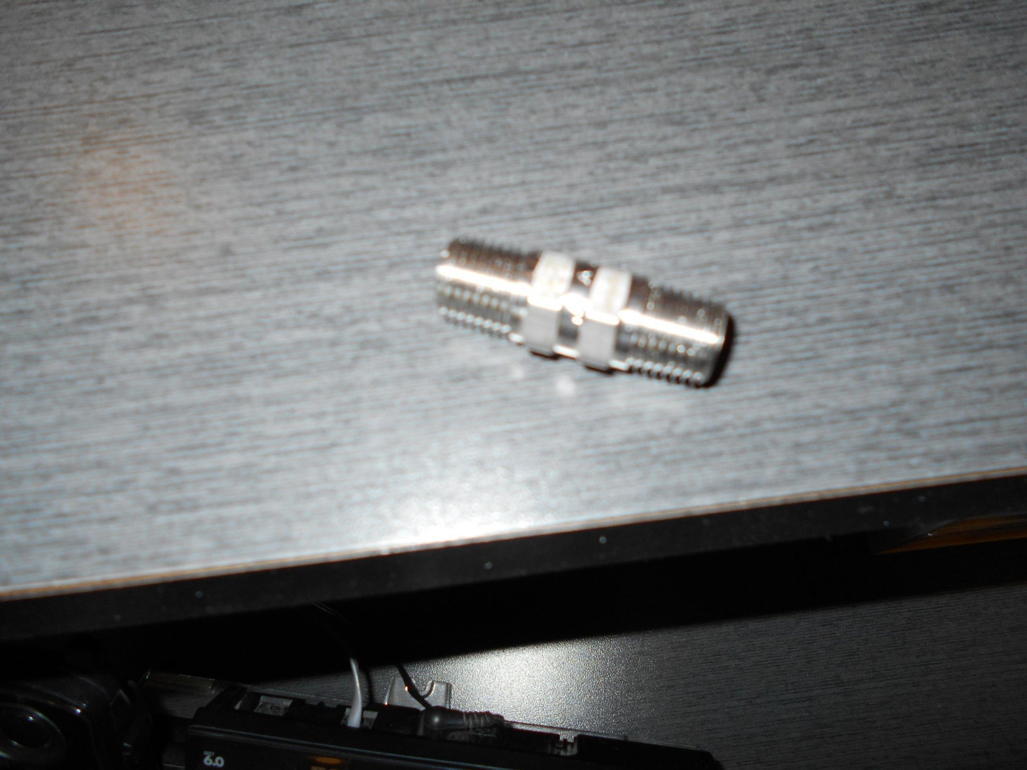

SABER28 03-17-2021 10:20 AM
hylok cva-m4n-a is a stainless valve that is adjustable. used air pressure to set the screw in the valve to open them at 35 psi. they are screwed in the block oil passage on the side of the block up front by the timing cover.
i used one per engine and split the oil lines to each valve cover.
https://cimg2.ibsrv.net/gimg/www.off...c2153f73ec.jpg
its one of those things i never would have know existed.
SABER28 03-17-2021 10:23 AM
for reference its about 2 inches long and has 1/4 npt pipe threads
getrdunn 03-17-2021 10:27 AM
Perfect. We’re on the same page. I was having a brain fart. Tks for the part number also.

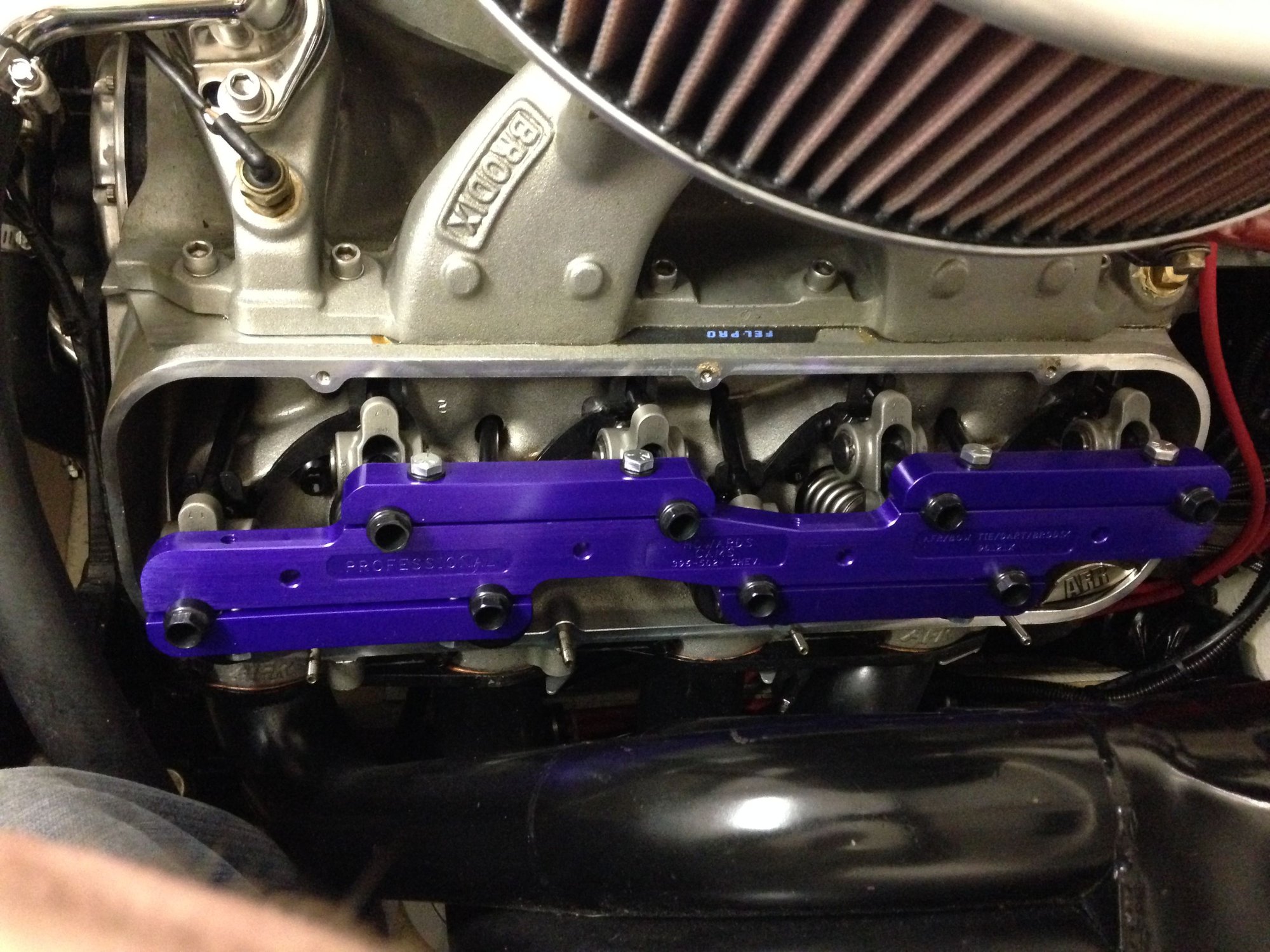

https://cimg0.ibsrv.net/gimg/www.off...21600ff947.jpg
I also make sure my boat insurance is paid on time. I found the guy that makes them for AFR, Dart, Howards etc. He literally had heads from all of them to check the fit. I have AFR heads and the Hardin valve covers as well, no problems.
