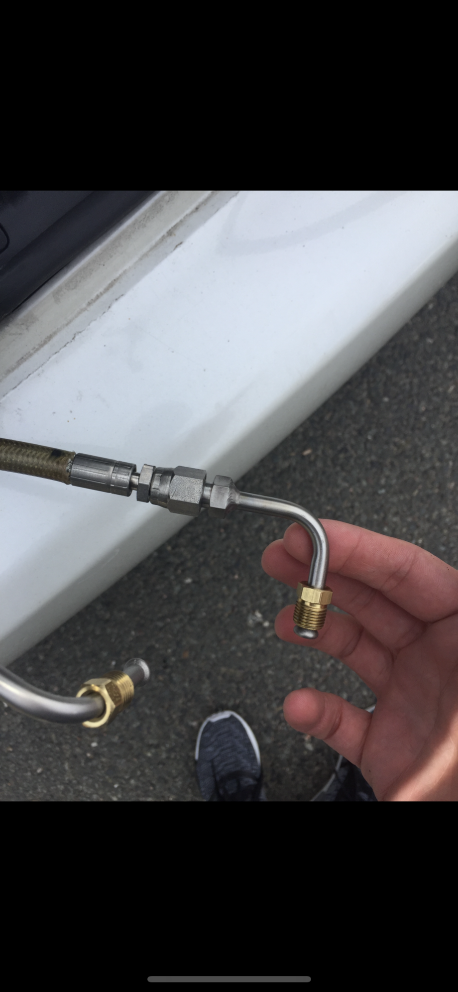

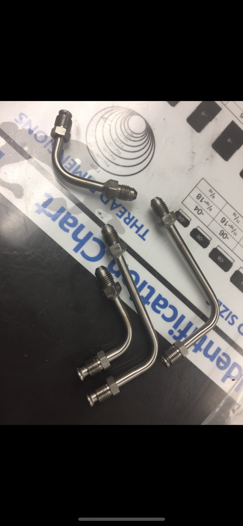

had these fitting custom made...so we could re-use hydraulic lines in boat.
1MOSES1 is offline

Ahh... the dreaded reverse flare fitting. I'm in Jacksonville, FL and there are only two places that will make those. Had to do all my hydraulic lines for tabs, steering, and tilt/trim. What a pain just finding a shop that could make them.
