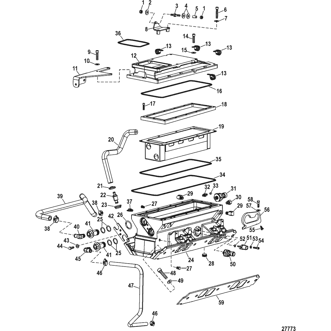

I'm sure I'm not the first person to do this, so here is my problem. After finishing the top end on my 600 SCIs this evening, and thinking "that's done", then I noticed my intake heat shield still sitting on the bench. I'm sure it should be installed, BUT does it need to. I have a hundred other things I need to get finished, and I really don't feel like tearing off my intake to install the heat shield if it really isn't needed. I rerouted the intercooler pick up line so the intercooler is going to be cooler than it had been in the past. So is it a big deal if the heat shield is missing, or is this a must have item?

Unless you want to relocate the PCV valve, you’ll want to put it back in, otherwise , you’ll be using oil

IF There is a pcv on the intake manifold like the na blue engines , it will suck oil like mad without the intake valley tray.
Any of the valve cover holes baffled ?
It appears cv or pcv is put into intake:
https://www.mercruiserparts.com/bam/subassembly/31381/14331/170

Unfortunately I'm not going to be around the engine until next weekend. Honestly, I can't tell you how it is rigged. I'm hoping someone is familiar with this engine to say, no problem, or no way. So far it is sounding like I better plan on removing the intake. Ha, I was also just looking at the parts diagram trying to get some incite on this. As to the valve covers, I'm 90% sure they are not baffled. If this is a must do, I want to order new intake gaskets because I won't be walking into my local parts store and getting them.

Mike I get the time thing. Difficult with your limited time and travel distance to and from. That had to be a oh fk moment I’m sure 🙈. I was going to suggest just put a baffled valve cover on or modify yours and deal with the tray later. I just don’t know if any sensors would put the engine in any default mode. I wouldn’t think but.... That’s the way Sr’s blowers engines were vented years ago and no known issues.

Its there for a reason put it in.......

HA- Yes I'm sure it's there for a reason. I ordered the new intake gaskets this morning, it will be going back in!
