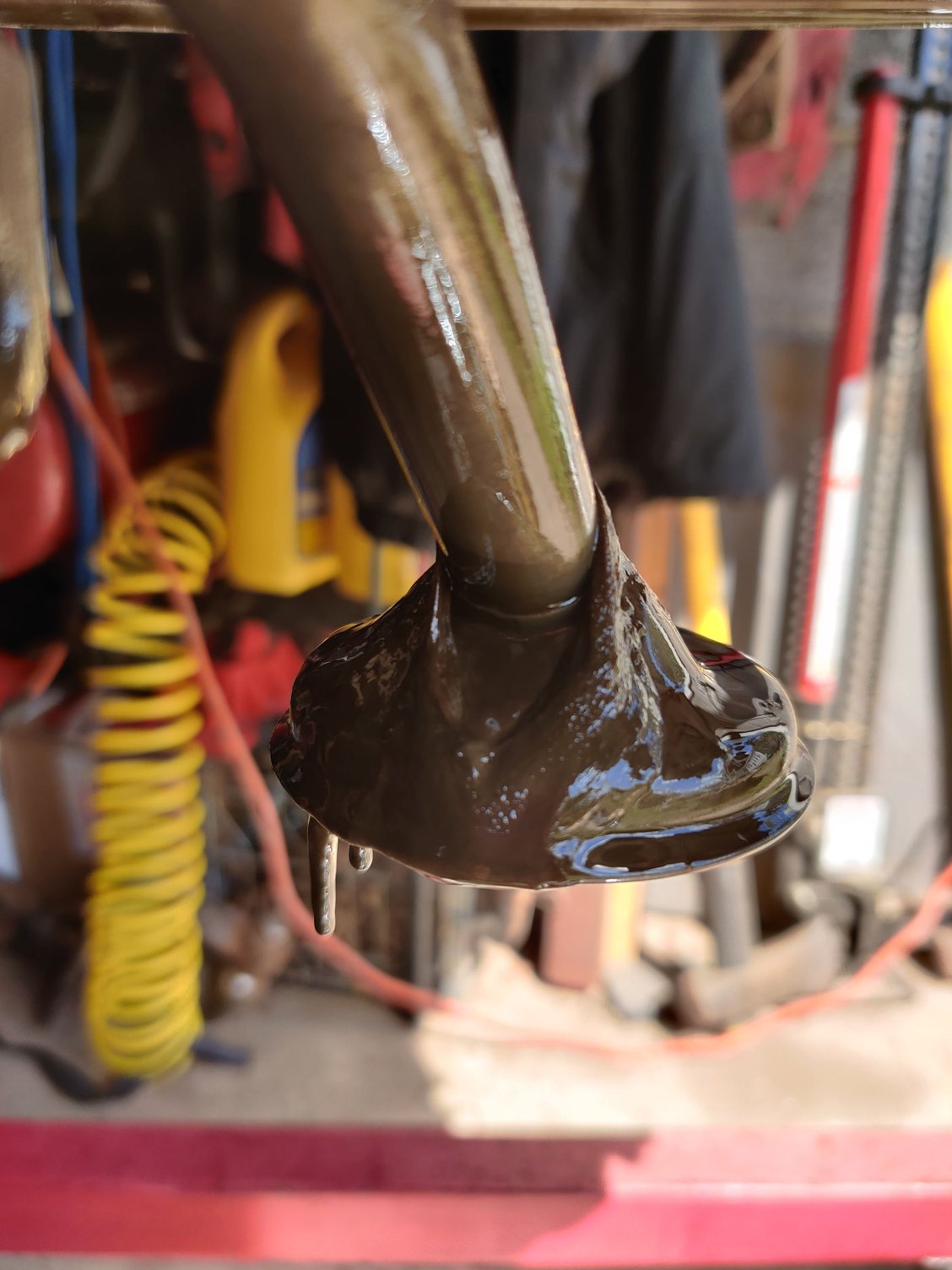

That's a good point. I was thinking they might just have crap oil plugging them, but you're right. They could have delaminated on the inside. This is what the oil pickup looked like when I tore the engine down. She was ugly... PO had no clue how to maintain a motor obviously. Oil change? What's that?
