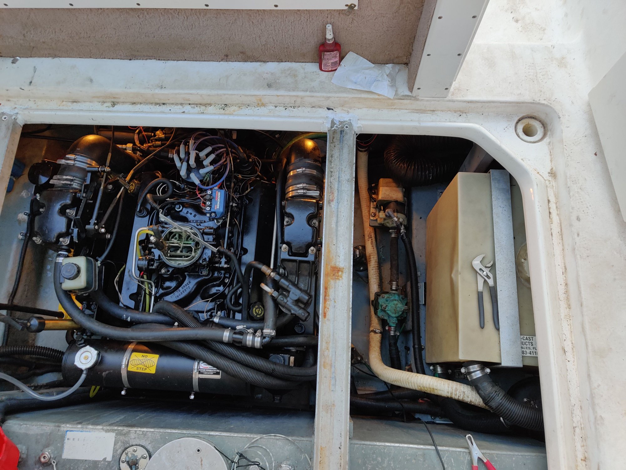

Here's a couple pics of the missing plugs and after I installed them.

Ahhhh.... She's running great with perfect oil pressure. Thanks again for all the help gents. It's running a little hot, but I think it's because I still have the timing advanced. I'll put it to the 8 degrees base timing later today. It was fun, but I wedged myself back in and re-installed the remote oil filter before I changed the oil.
