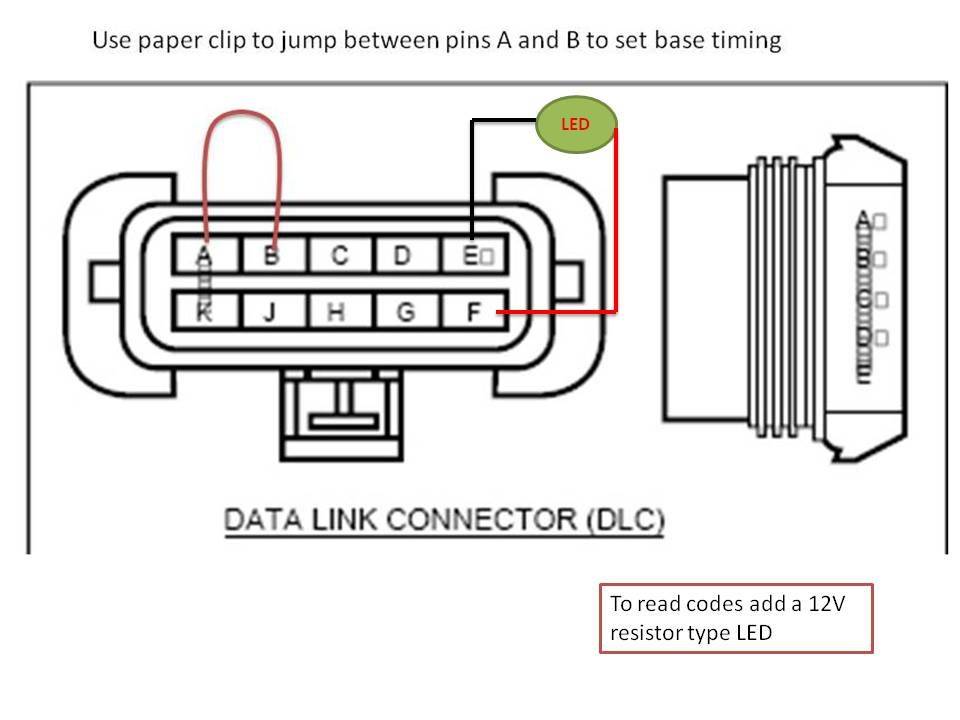

AllDodge 06-08-2021 05:14 PM
Yes, paper clip pins A and B
Can also read codes (if any) with a resistor type LED or using a digital meter with tone mode

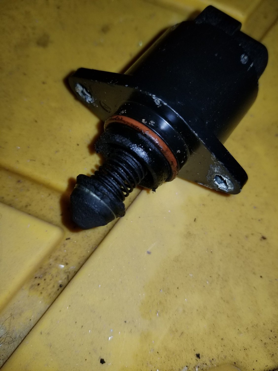

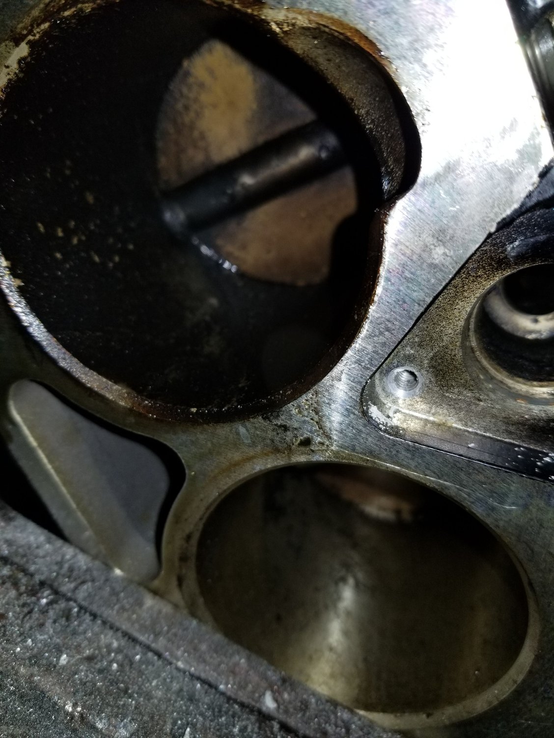

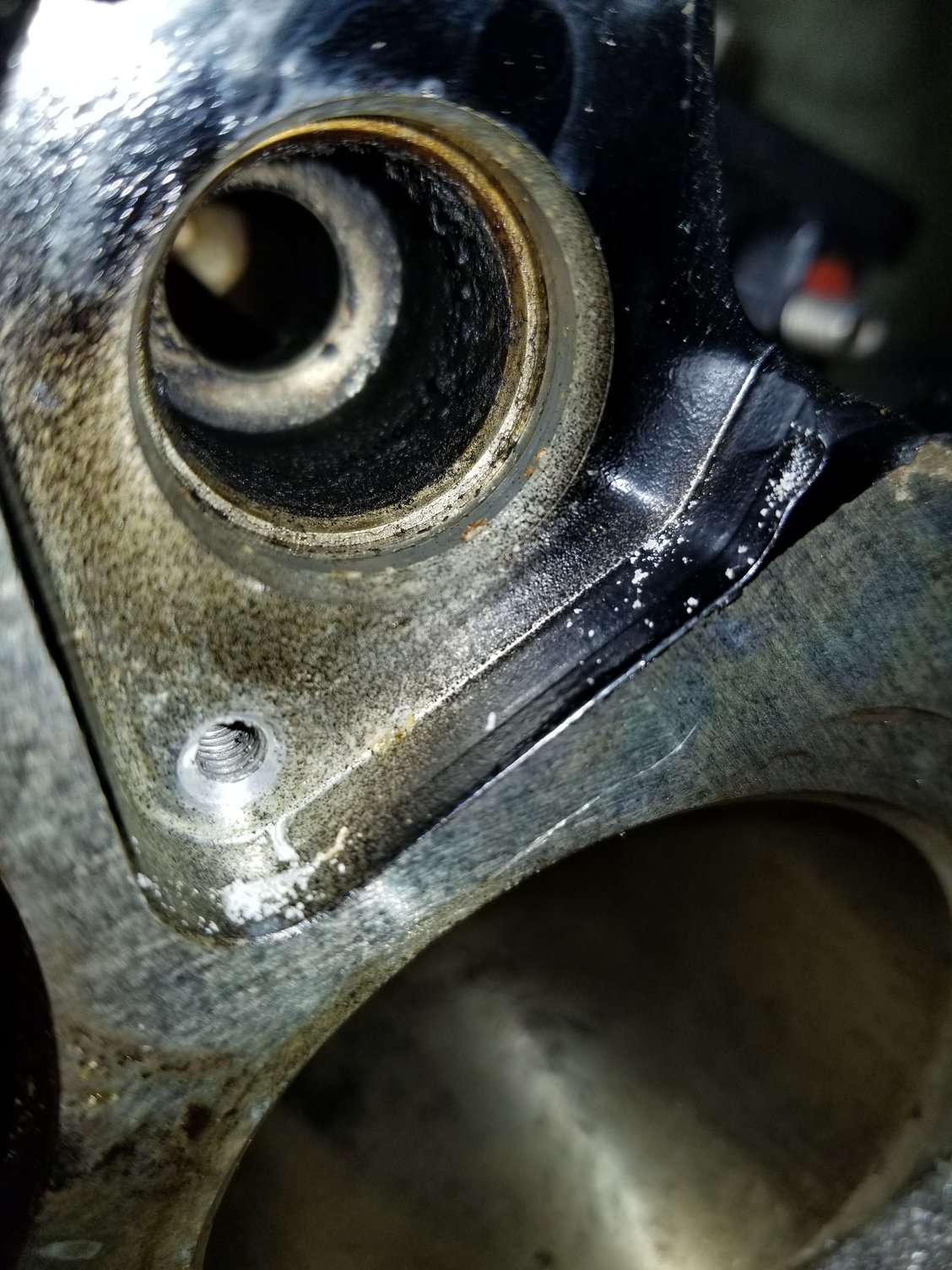

bdbwtie 06-15-2021 10:37 AM
Well Im guessing I found alot of my problem. Ive been reading alot of topics on the injectors in these and cleaning them should be routine maintenance, so I pulled them out lastnight and sent them to smitty. In the process found my throttle body extremely gunked up, iac and iac port where full of gunk. So cleaned throttle body out, replaced iac with new, now waiting on the injector report. Fingers crossed
https://cimg0.ibsrv.net/gimg/www.off...a7628dbbd3.jpg
https://cimg1.ibsrv.net/gimg/www.off...dc8ecf6c70.jpg
https://cimg4.ibsrv.net/gimg/www.off...66dfffe062.jpg

Padraig 06-28-2021 03:38 PM
What would cause the IAC to get so gunked up?
Padraig
SB 06-28-2021 04:01 PM
Padraig
Crank case vapor. Happens in all motors but the 502s have a low tension oil ring on pistons from the factory so even fresh it has more blow by than Other motors. Multi port injection put injectors below the intake me and fold so none of that stuff gets naturally washed off
