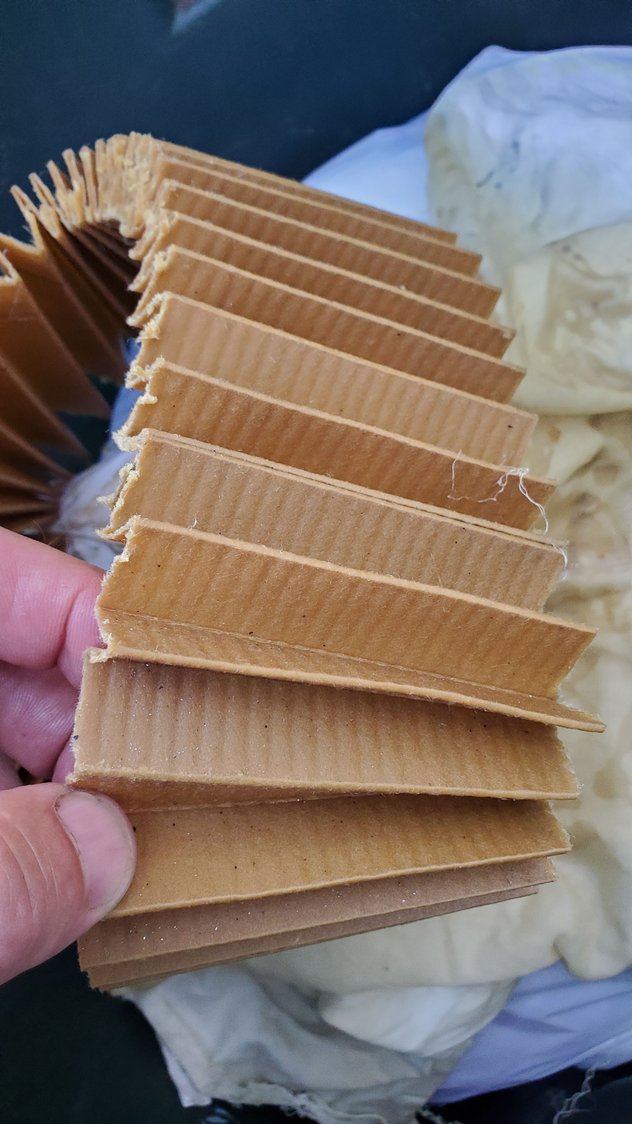

Originally Posted by Griff
I run Mobil 1 Filters. My second choice would be K&N. Both use a synthetic filter media that won't swell if you get moisture.
I stand corrected, media is synthetic blend on K&N. This was the last one I cut open.
