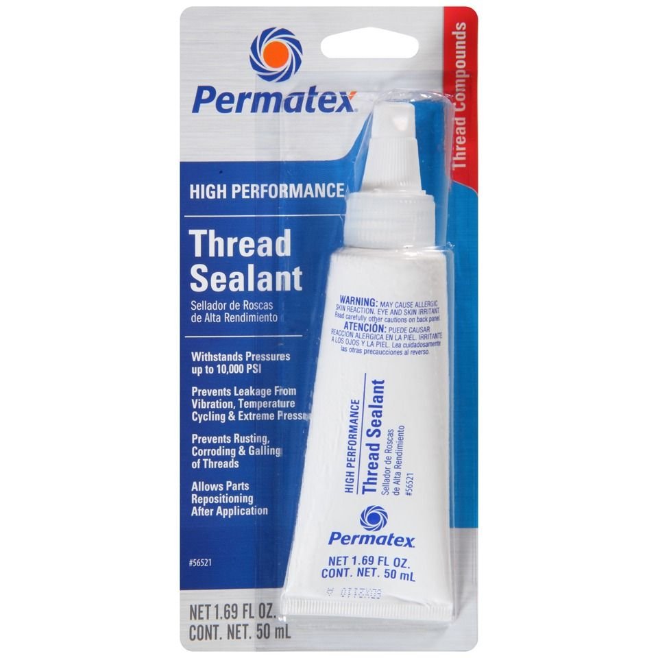

Thank you, will be looking at those today. Owners Manual actually speaks to the federally mandated Anti Siphon valve, that the fuel line connects to top of tank. That has a spring and check valve like ball in it, can get worn, corroded, etc and not be able to collapse the spring to get fuel flow.
Anyone know, is there special thread seal or other that needs to be used when replacing? There's some beige putty color thread seal on there now...

I use this on all automotive/marine pipe thread fittings, gasoline/oil/water/coolant
Available at pretty much every auto part store
