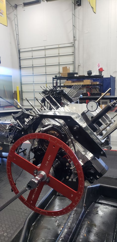

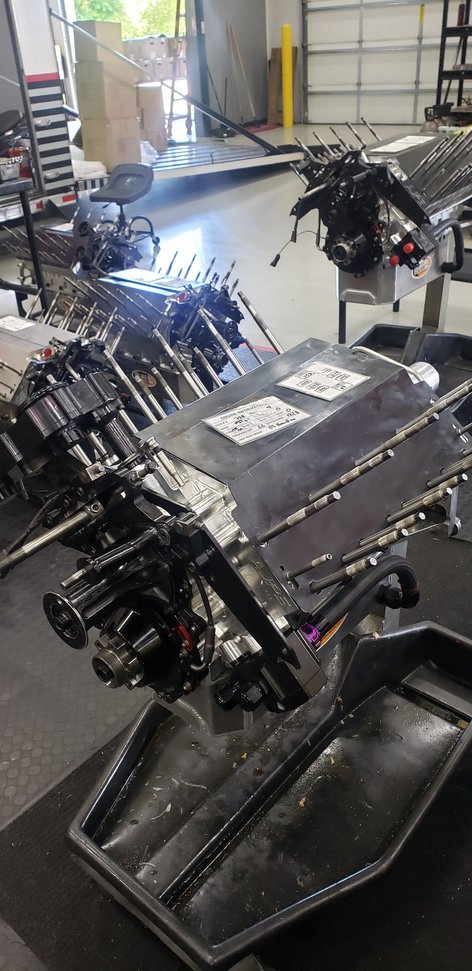

Tfmech 06-24-2021 07:19 PM
https://cimg0.ibsrv.net/gimg/www.off...269996ea72.jpg
https://cimg8.ibsrv.net/gimg/www.off...d7a0bead94.jpg
part of the arsenal for the weekend
SB 06-24-2021 10:27 PM
Awesome stuff. Thanks for the pics !
