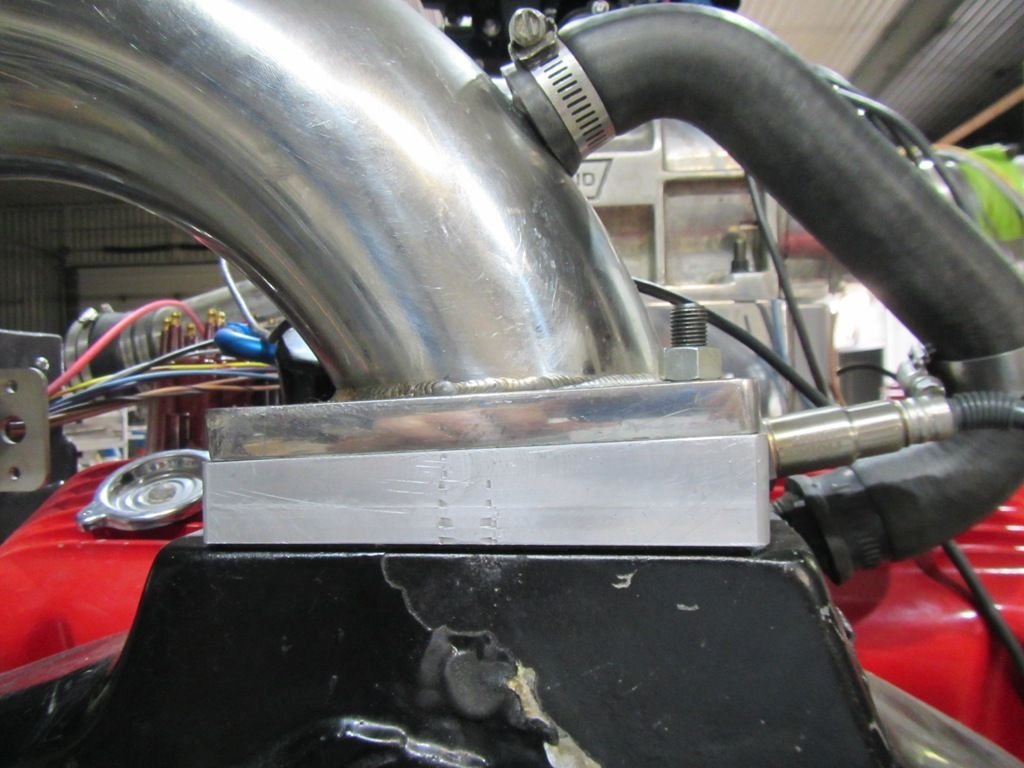

I thought about putting the wide band on it....just don't best way to go about it. Think it will get too much water with a block under the riser. Then there is put it right up next to one of the ports where there is no jacket or go through the jacket with a sleeve.
Really what to try and do it with out messing around putting the O2 sensor on it.
