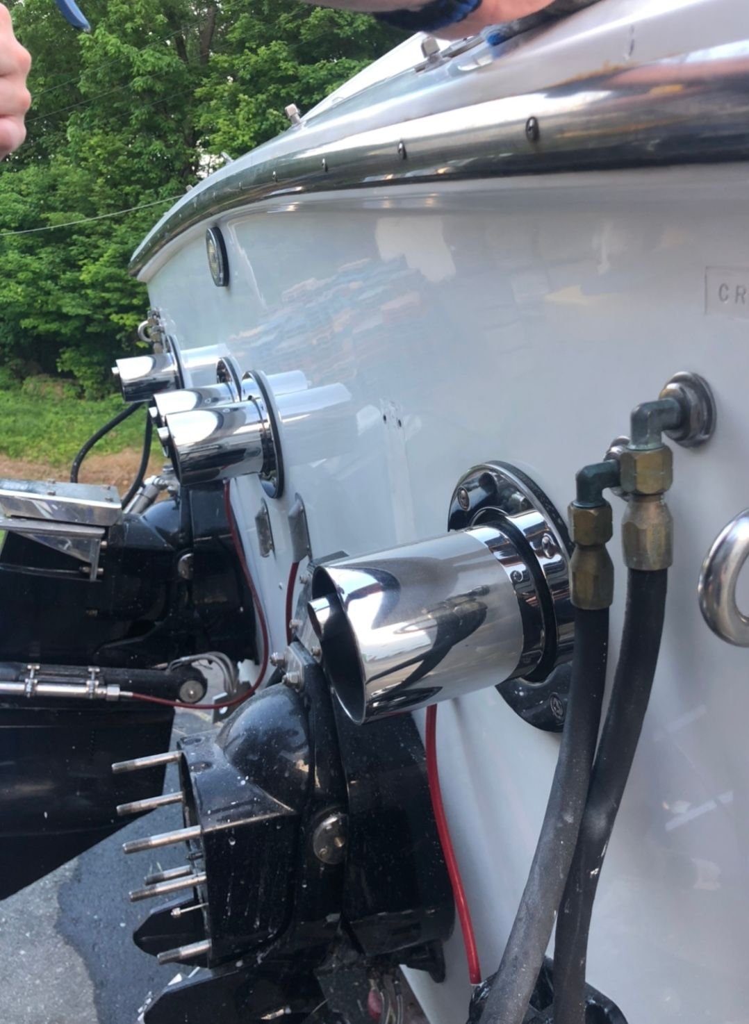

Here are the new hoses after 3 years…don’t mind the white crap we were wet sanding.
like I said I’ll be replacing hoses from dry rot before the brass gives up.

A little advice on using SS hoses. If the hoses touch any of the gel, they will likely rub through the gel over time. Maybe not visible in the straight on position, but when turning, there may be some light contact. Even the rubber coated hoses over time will cause visible wear marks. Just FYI. For what it's worth.
