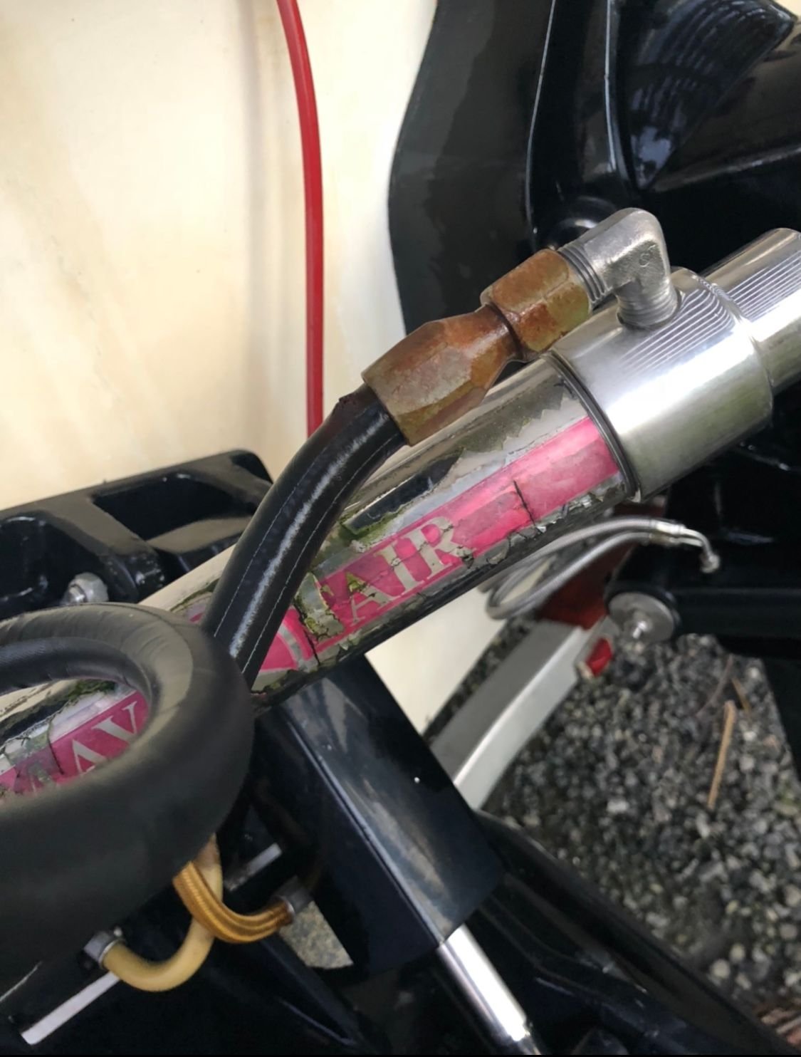

Old 06-29-2021 | 10:18 PM
Joined: Jun 2010
Posts: 4,838
Likes: 928
Here were the hoses after 13 years. Maybe more…as you can see the coating was long gone.
