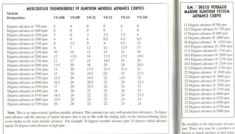

Since you have the Thunderbolt IV what is the module number? It should be a v8-22 that will advance your timing starting around 1200 - 2000 RPM or possibly even lower(I can't remember the exact start of the advance curve). This module had 22 degrees of total timing advance. If you start at 8 it should give you a total advance of 30 at higher RPM. Can you run it up to/close to where it is backfiring and get a timing reading?
454 Mags use a V8-24 advance module

Thanks Griff! I knew someone here would have the Advance curves.
Reg, get a timing light and test if you are getting any advance with the module connected. Harbor freight even has a fairly cheap one that has a dial on it to assist you with knowing where you are at. They aren't the best but they do work!
