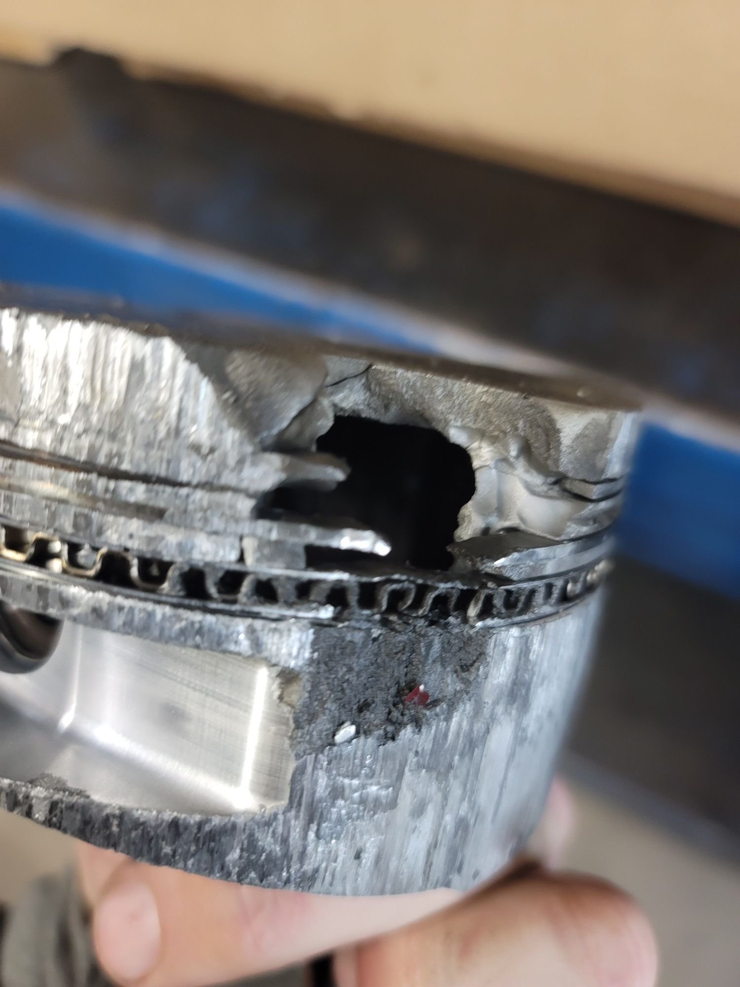

Piston update

jb weld and a polishing wheel =,good to go.
what cylinder was that?
sutphen 30 is offline

5?

Is that the intake side of the piston. Looks like detonation. Or combo!

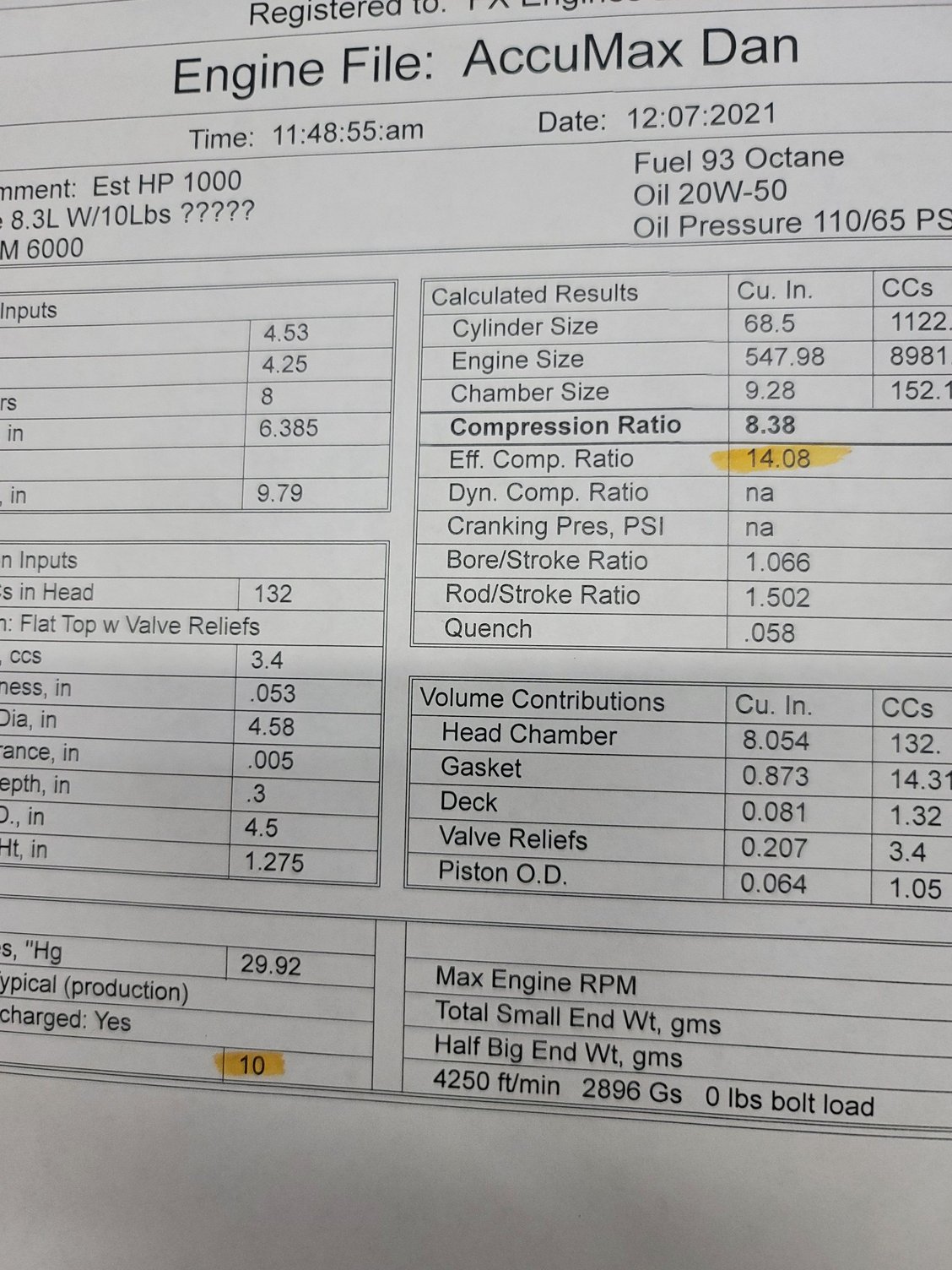

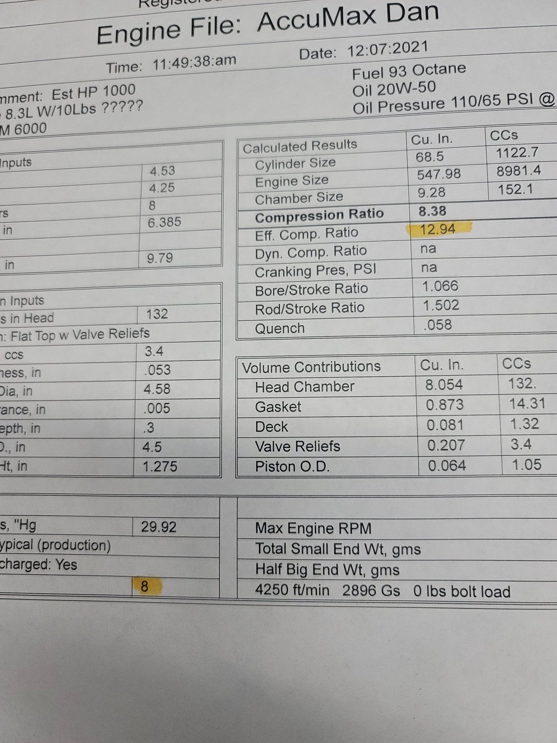

#5 and 6 on both engines .
You can see the heat at the bottom of some of the pistons (burned oil), others are like new.
Ive learned not all gas stations are the same , if it`s not top Tier fuel it`s kinda junk and more prone to detonation.
https://www.toptiergas.com/
Secondly, my effective compression with todays fuel is too high (engine builder opinion) with 10psi. My engine builder says at 6psi it`ll live a good long life, 8 psi on the edge , 10 psi better use race fuel.(14-1 compression no bueno)
add into that a tight wall to piston clearance .045 one engine .055 the other , no room to grow.
add to that I leaned it out to 12.5 afrs at 4000rpm and 32* of timing. My other tune was 28* and low 12s .... and here we are .
