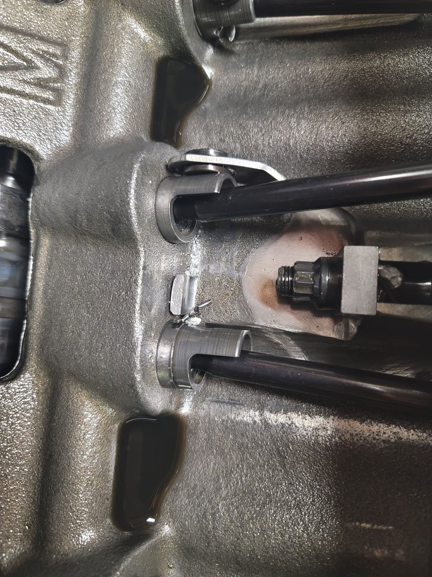

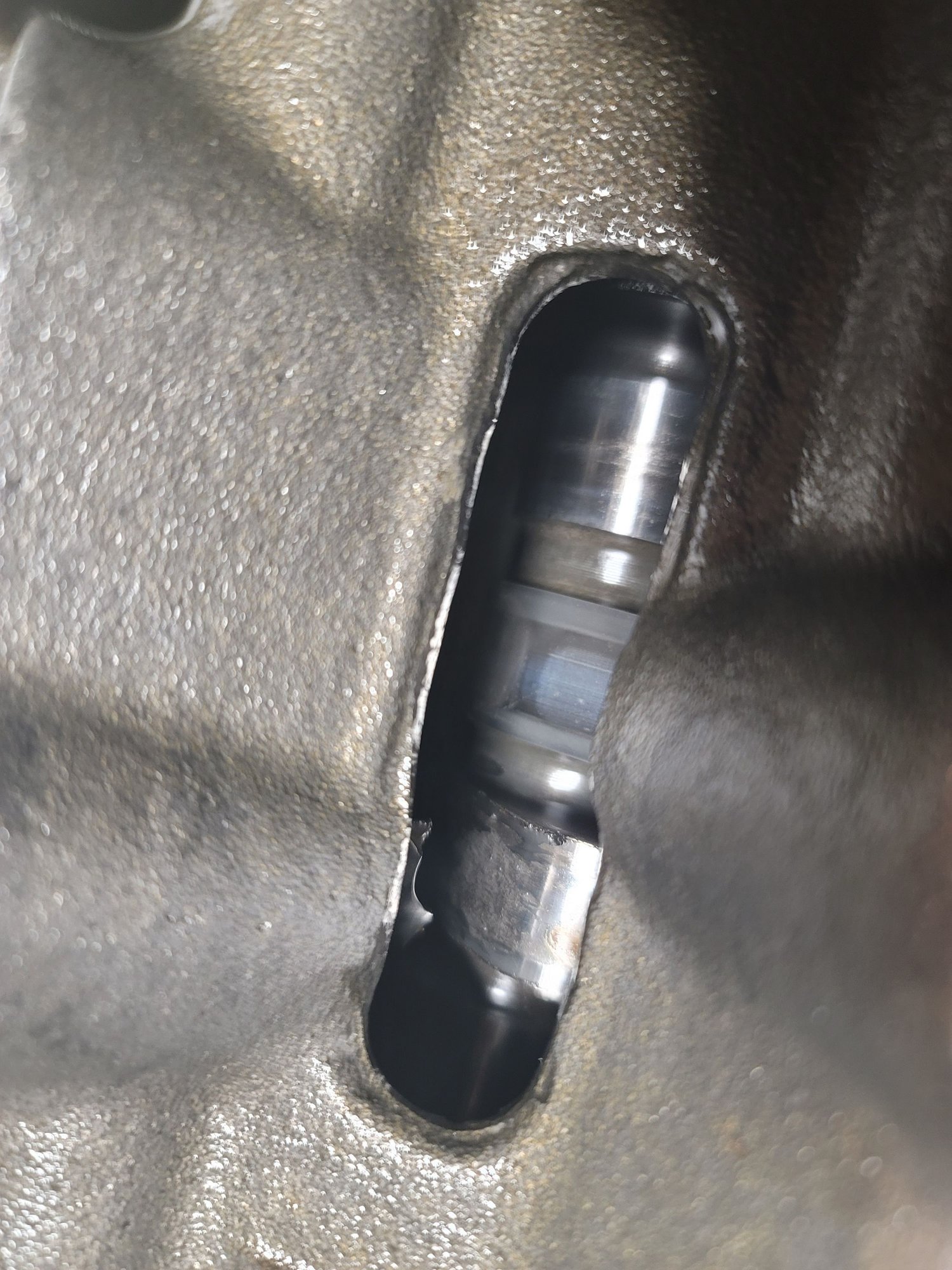

I`ve stated that I had no issues running these lifters . I was wrong.
The forks on most have spread making them very hard to take out the bore.
Tie bar also broke.
I`m running 240/586 spring pressures which certainly doesnt help but after 2 seasons they are all about to take a dump.
The rollers are gone and the cam is shot

Yikes! Probably didn’t have much time left on them. Like that in both motors? How did those broken pieces not cause a catastrophic failure?

That sucks man. Had a set of Morels do the exact same thing. What are you going to replace those with? ISKY/JOHNSON? Solid/Hyd?
not sure which happened first ................
Isky which uses the johnson body .Im thinking short travel still.
Solid rollers would just be too much trouble t adjust every year

That a lifter wheel in that pool of oil the second to last pic?

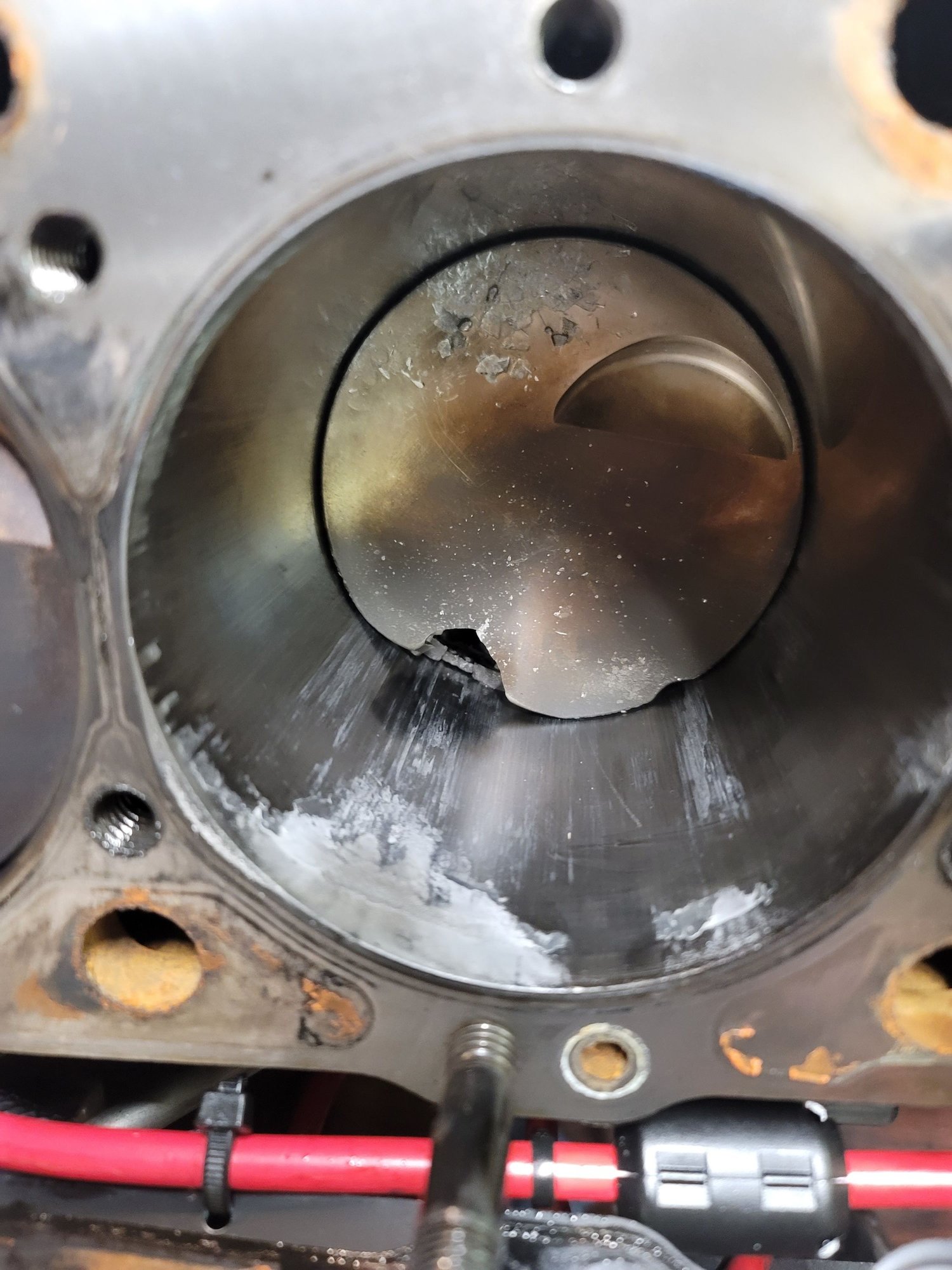

so yes, I had the bad gas episode rebuild all the heads and one motor.
That was 3 months ago or so .

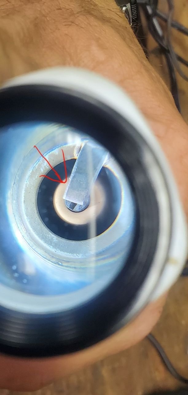

After that I posted a data log of my run and how nice everything was running on Fakebook and some very well known engine builders told me I`m washing down my rings and I need more timing . at 3700-4000 (3lbs boost) I had 27* and low 12s
I spent some time trying to read plugs to see if this was true. I can`t read a plug to save my life but it looked like the timing mark on the strap was indeed low on timing.
I changed my map to 31.5* at 4000 and 12.5AFRs .
4 hours later I had a hole in the one piston, broken lifter and the engine that was fresh has a scored cylinder .... both motor on the #5 hole.
Efi is too easy to make changes I should have left it alone AND I should have stuck to MY tune . it`s worked for years.
I`m a dumbass. Now I`m paying the price ..
