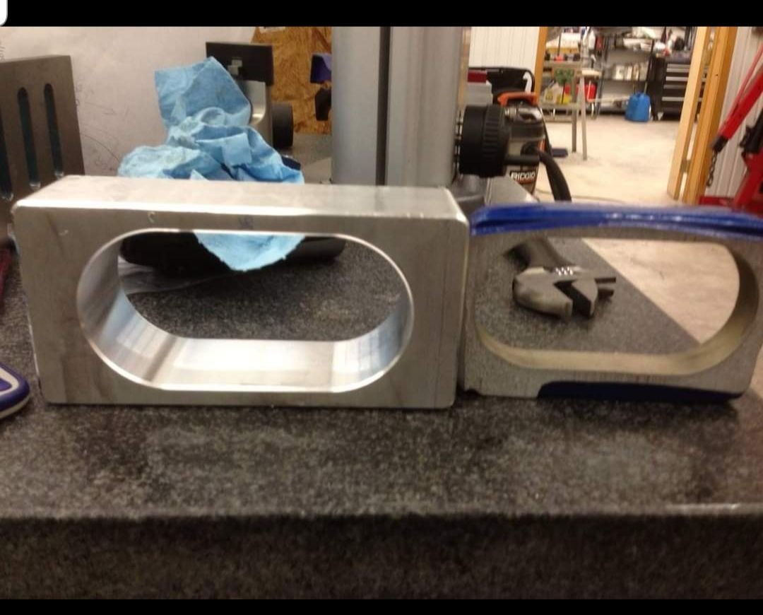

Our finished 525 throttle body.
Spacer to extend throttle body out to help #1 short radius.
525 liwer ported.
Lower with big injectors installed.
525 stock throttle body.
525 intake top with stock plate cut off.
We were able to achieve 700 hp, 700 lb ft. With these intakes.
565 cu in. 9.3 comp. But they were done. Came to the conclusion it would be much better and cheaper to just have intakes made to what we wanted. The nice thing about sheetmetal intakes is you start with a clean sheet of paper.
