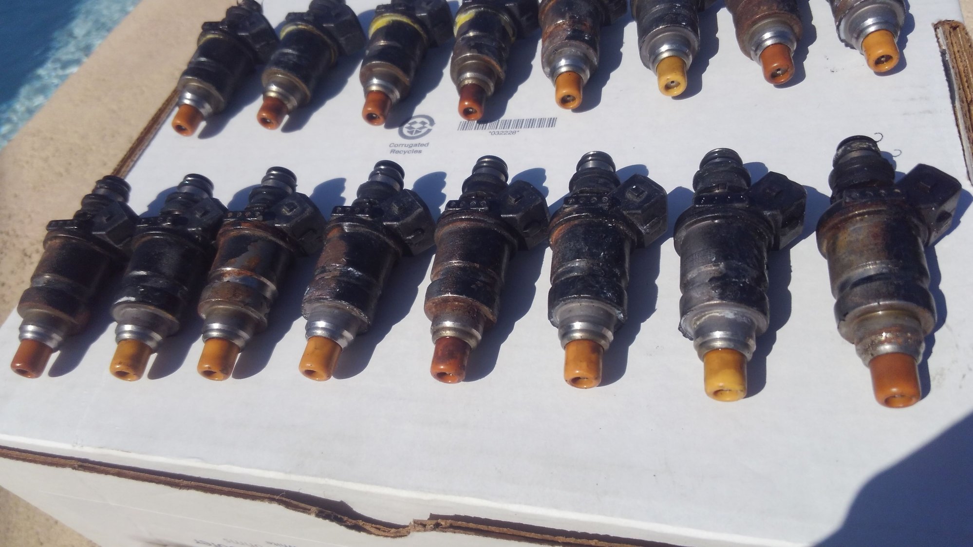

Plenums and fuel rails off, injectors out. They look pretty crusty. Several visibly distorted or damaged o-rings, and many of the spacers (?) at the top of the injectors are badly distorted or compressed. This pic is after a brief soak / rinse in gasoline. They were significantly worse beforehand.
Think it's worth sending these out or should I plan on finding new?

Send them to Smitty ( Articfriends ) on here he's rebuilt and flowed several sets for me and others.
X2 that’s the route I’d go so when you reinstall once you get them back you know first hand their gonna be right. Heck even ordering new ones you still don’t know what your getting or if your gonna have failures.

Sent you a message on injector service. The "32" psi you seen, was that at wot when it wouldnt pull at 4000 ish? Bad regulators usually allow fuel pressure to drop to about 26/28 psi at wot, with your cool fuel pumps, with no vacuum, you should be around 38/39 psi , 35 MININUMUM, Smitty
