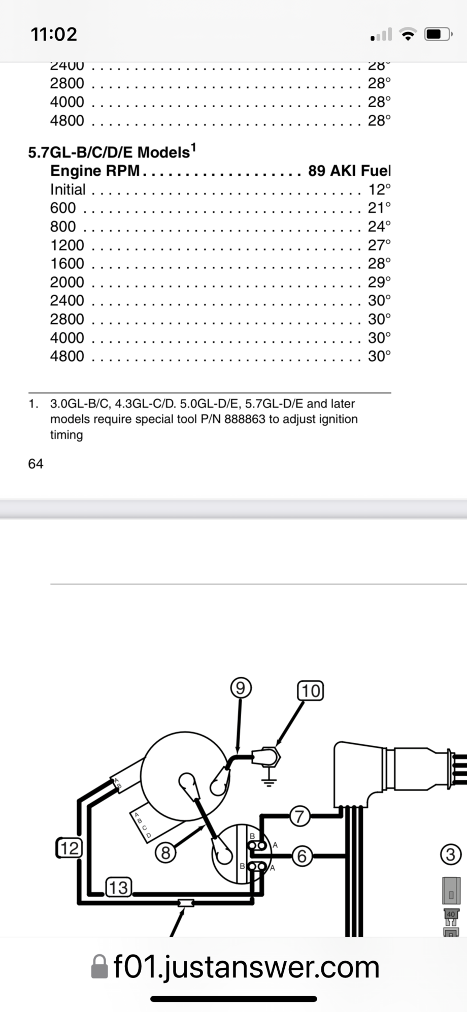

Here is what volvo shows with running this module/distributor on their carbed 5.7.
Again, looking at this shows why many timing their engine thinks these modules have no advance. Most all of it is in at normal idle speed.
Another reason these dist’s/modules good on bigger cammed performance engines compared to tbolt iv dist’s /modules especially
You can also hook the Daytona Sensors box too it, of course, like you can with other type dist’s…if you want programmable timing. Simple, just bypass module and use dist as magnetic pickup.

Originally Posted by SB
8 pin GM modules . Can’t vouch for the DUI replacement.
When you remove the 4 wires attached to right side of dist, as we do for cabureted app’s, you lose the 5 volt ref and ecm ‘timing’ wire connection. When those aren’t there, the module uses it’s own advance curve.
For carbs, we just run + and - to coil, then attach two other terminals on coil to two wire connector on dist. Again, nothing plugged into 4 wire connection on dist.
Now, so much of the advance is under 1000rpm and alot under 600 rpm, most with a timing light don’t see this and think the module has no advance.
Diagram shows hook up. Diff fist but same deal. GM est/voyager dist just plugs in with two wire connector.
Yep, still not sure where cuve or advance would be coming from as I only know the module to convert the pulse to something ecm can use.
Now heres my "test" for sake of discussion : If I hook my MSD Ignition 8998 to those 2 pins coming from dist pickup to input side of module (I often do this trouble shooting) using it as a signal generator, I can simulate the engine going anywhere from 10 rpm to 10,000 rpm, a standard brand module will smolder after 30 seconds much above 5000 if the rest of mefi is plugged in, a merc or dui will take 5600 briefly in air, more if mounted to something to pull heat from it i ended up mounting one on aluminum as a heat sink .
Anyways, IF I go in the mefi ecm program and I set timing to say 15 degrees in every map vs rpm table, top to bottom, plug my lqaptop in, set it to scanner pro or plug a merc scan tool in, crank the signal generator between idle and 5000, it will show it commanding 15 degrees of timing top to bottom.
Now, if a mefi motors on my dyno, I again set those timing tables to 15 degrees from top to bottom, I set my actual jumpered timing at 8.1 to correlate those tables (FALLING REFERENCE ANGLE IN REGARDS TO NEXT PHYSICAL TDC" TO 8.1 degrees) rev motor, it will show that 15 degrees thruout the rpm range (it may vary a tiny bit lower from cam deflection, chain stretch as you rev it higher) but in general. So if the ecm dictates when to fire the coil based on timing tables, if the module started doing its own version, where would timing actually be and what would be controlling it?
