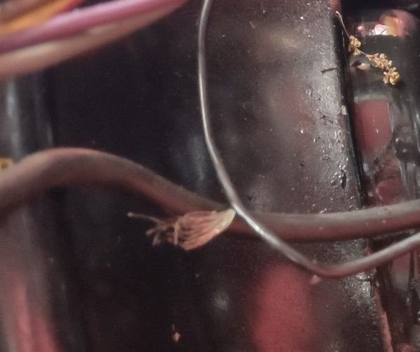

Winner winner Chicken Dinner!!!!
All Dodge pointed me in the right direction. I checked the grounds at the coil which I thought was the dist wire but, I had it and the other motor running to the transom grounds for whatever reason. Both will get moved tomorrow.
Looks like this ground got into the coupler. Lesson learned and thanks to all for playing along. Love this site.
