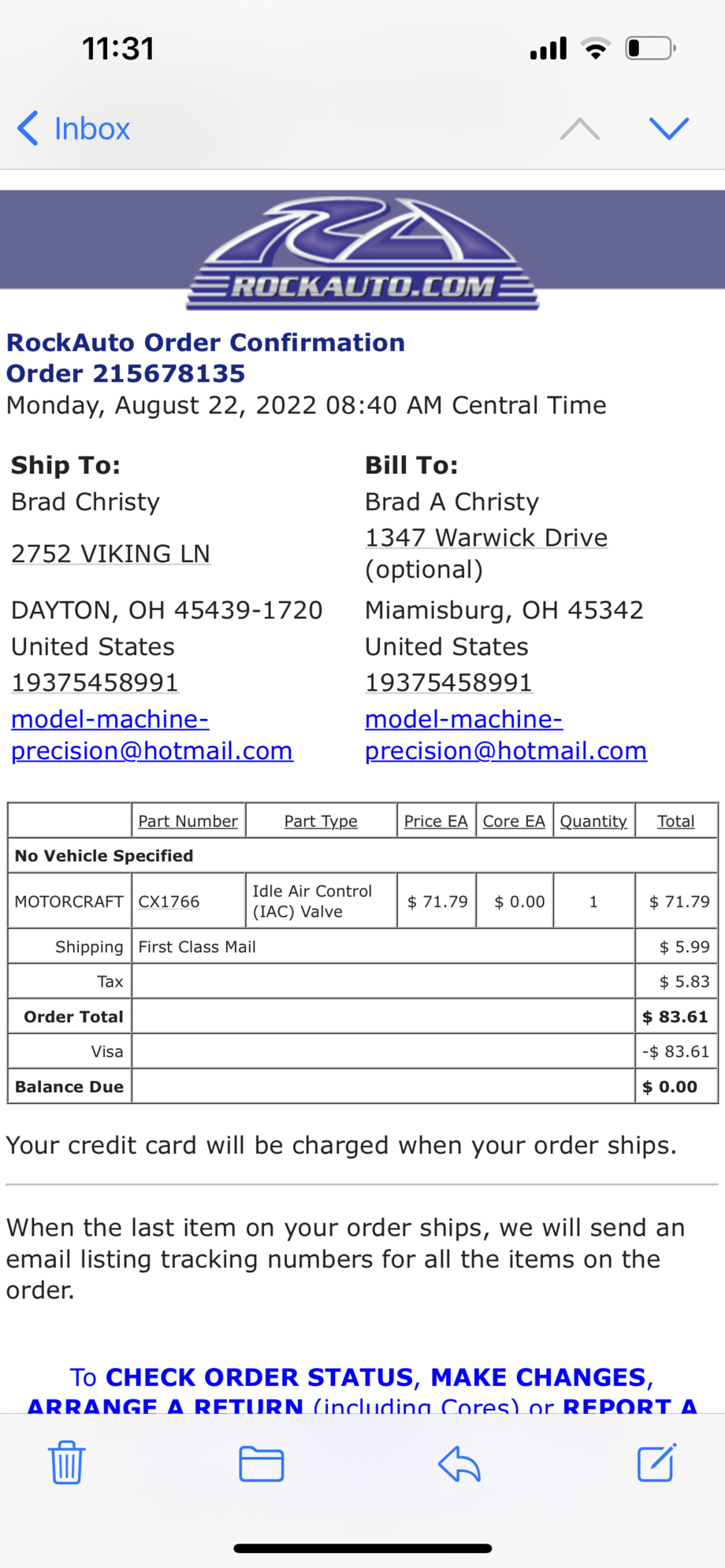

Guys,
Looking at IAC valves. Any reason not to buy the Sierra unit instead of the Quicksilver unit?
Thanks. Brad.

Guys,
Thanks. Brad.
(937)545-8991
Get the ford motocraft one. Do a search, we have deciphered the part #.

Old 09-19-2022 | 06:59 AM
  #280
Joined: Jun 2021
Posts: 3,533
Likes: 2,142
From: SW Ohio
SB,
Done did it. 😎
Thanks. Brad.
(937)545-8991
SB,
Finally got a chance to get the scan tool out and play with it a bit. I performed the IAC output test and got ZERO change in RPM from -100% to +100%. I'm assuming this is an indicator the IAC valve is bad. Since I already had the replacement part on hand, I swapped it out, but have not had the chance to get it wet again and fire it up for a final evaluation. Is it safe to assume the hunting idle will have gone away?
Thanks. Brad.
(937)545-8991
