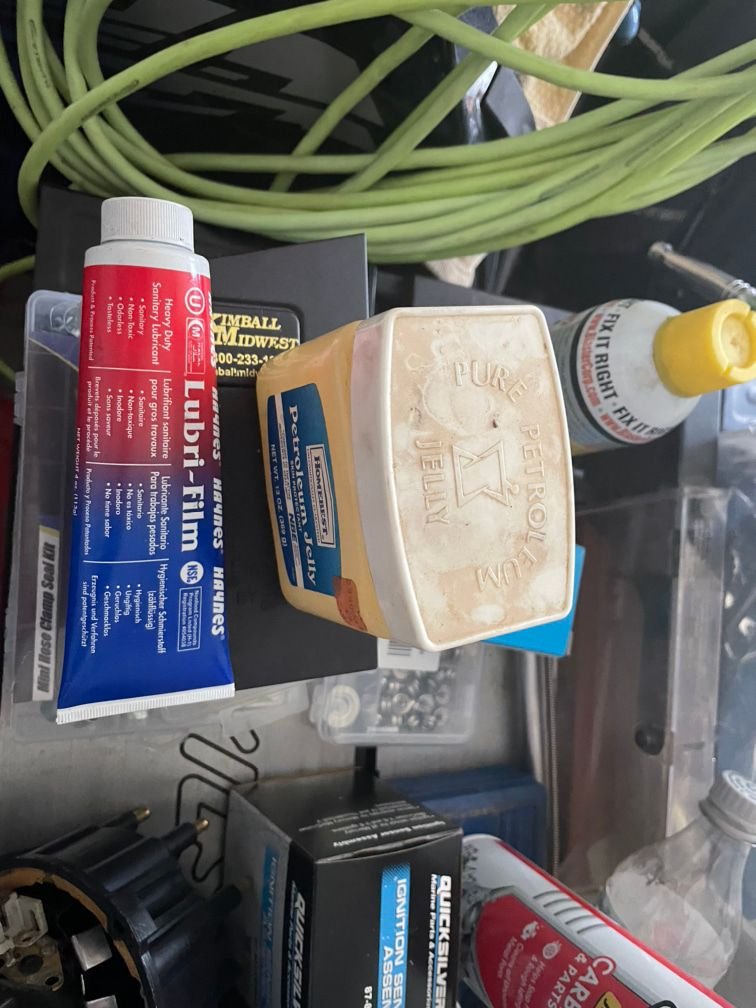

I wondered about using anything "petroleum" on O-rings. I know things like motor oil and WD-40 will attack standard Buna-N O-rings, causing them to swell and soften up. Didn't know if Vaseline did this as well.
I got a small packet of what appears to be white, semi-translucent grease from Mosetti with the new plug wires, presumably to lubricate the boots. Would this be the silicone grease we are all referring to?

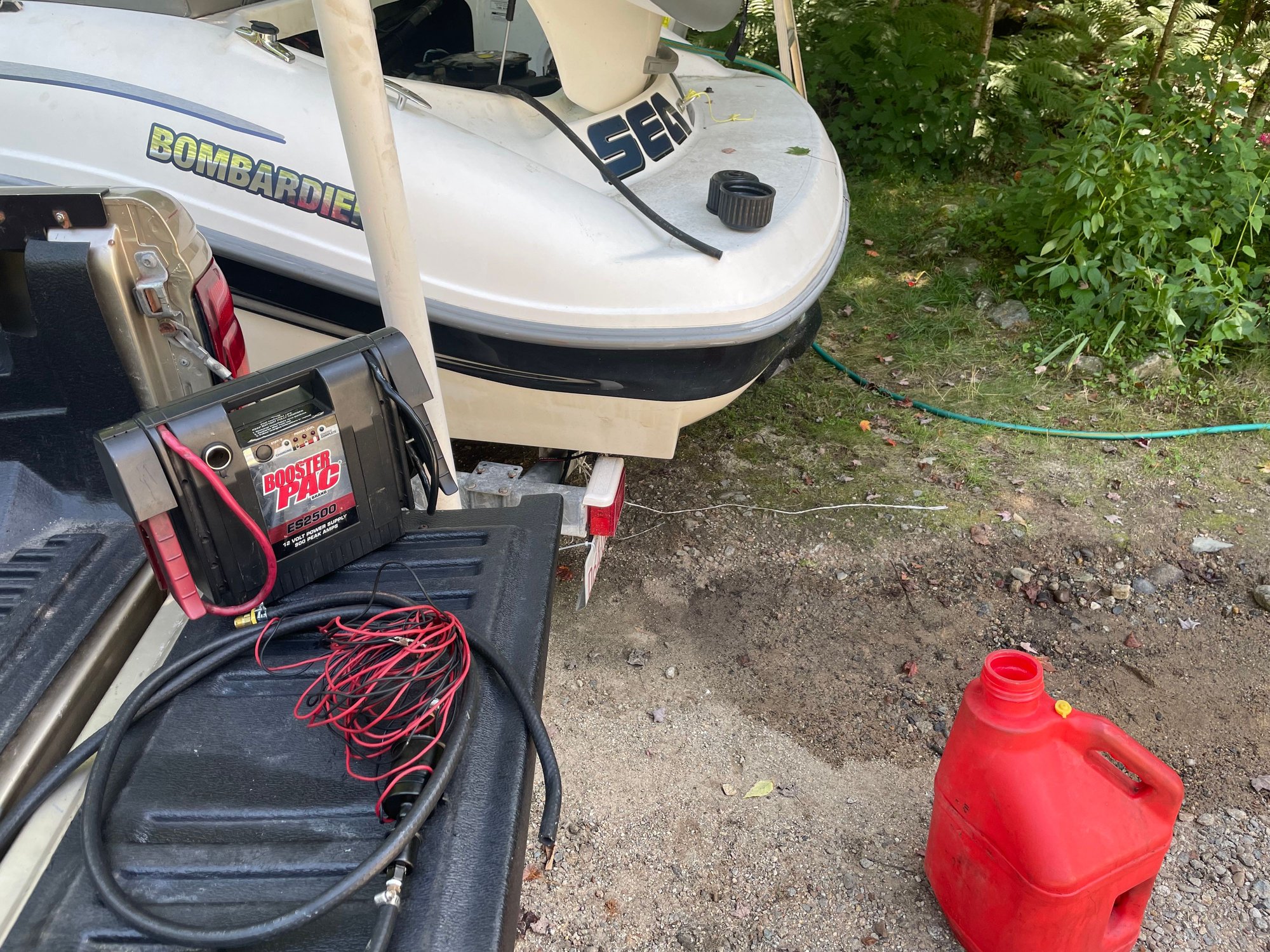

So, another reason to do the following winterization strp i learned from member sutphen30 very long time ago.
Remove water separator (add new or dump out) snd fill with fresh fuel 2 stroke oil mix. Many 2 stroke oils have fuel stabilizer mixed in. If not, add a splash of stabil. Run engine, when you see slight blue smoke from exhaust , the mix is in and being burnt. I do this for all fuel injected snd carbed engines.
Some people remove inlet line at separator and hook small gas filled of this mix to inlet and then run engine.
Not a good typer. Hope that makes sense.
Edit in: I just did that to this sea doo boat other day. You can see the fuel line i added to inlet so i could run on a small 2 gal gas can (not pictured) premix of fuel/oil.

I have always used dielectric grease on the o-rings with no issues.
