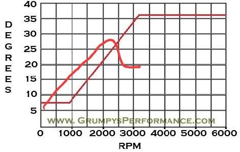

On many of these engines, The ecu and techmate assume you did initial timing correctly and show values timing should be if you did. It does not show you actual because it doesn’t know. This is why as you advanced distributor, it showed at timing mark with timing light, but not on the techmate.
So, now knowing this, is you total wide open advance actually wrong ?
I still think so as the timing drops from 2200-2400 rpms and then never increases again and only reaches a max RPM of around 3500. I drew a line on this graph to show what the timing is doing based on what I see on the techmate.
Is there any knock retard showing up? I think up to 9 degrees can be taken out when knock is detected.
