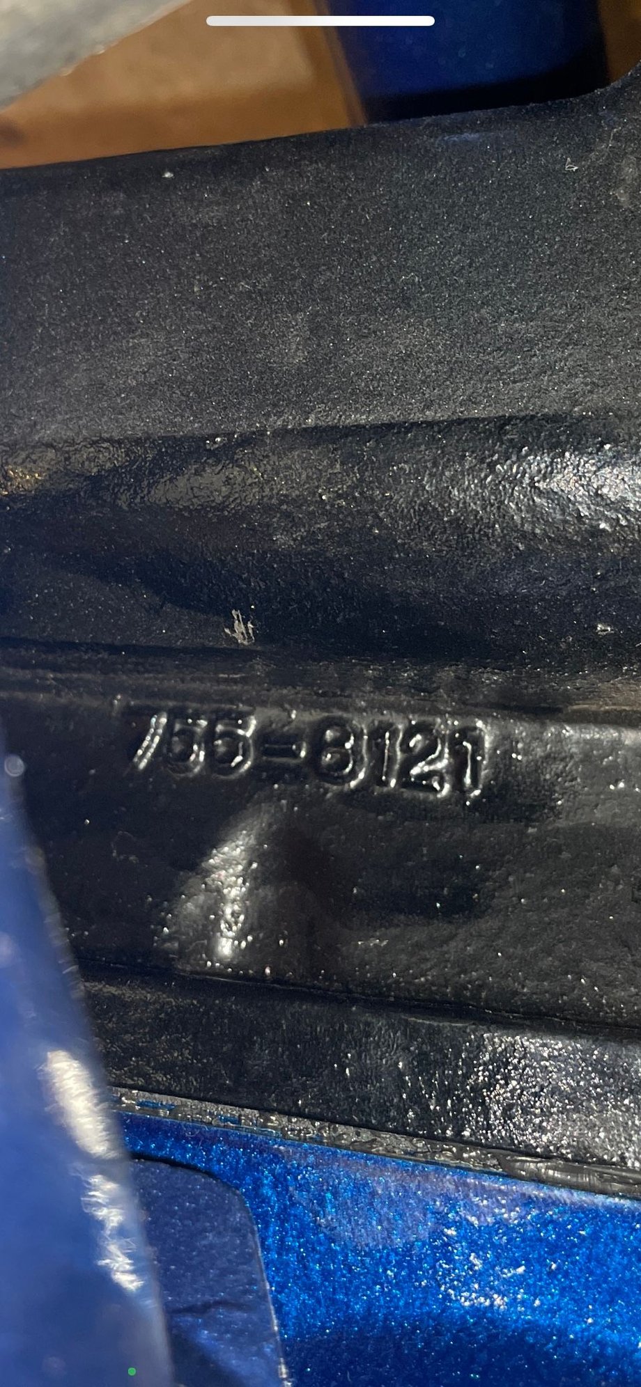

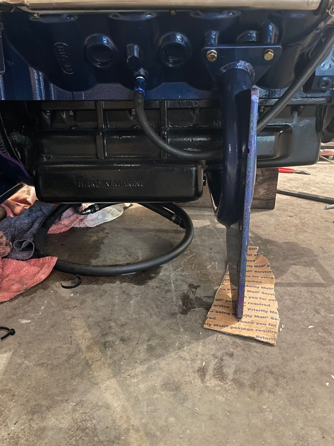

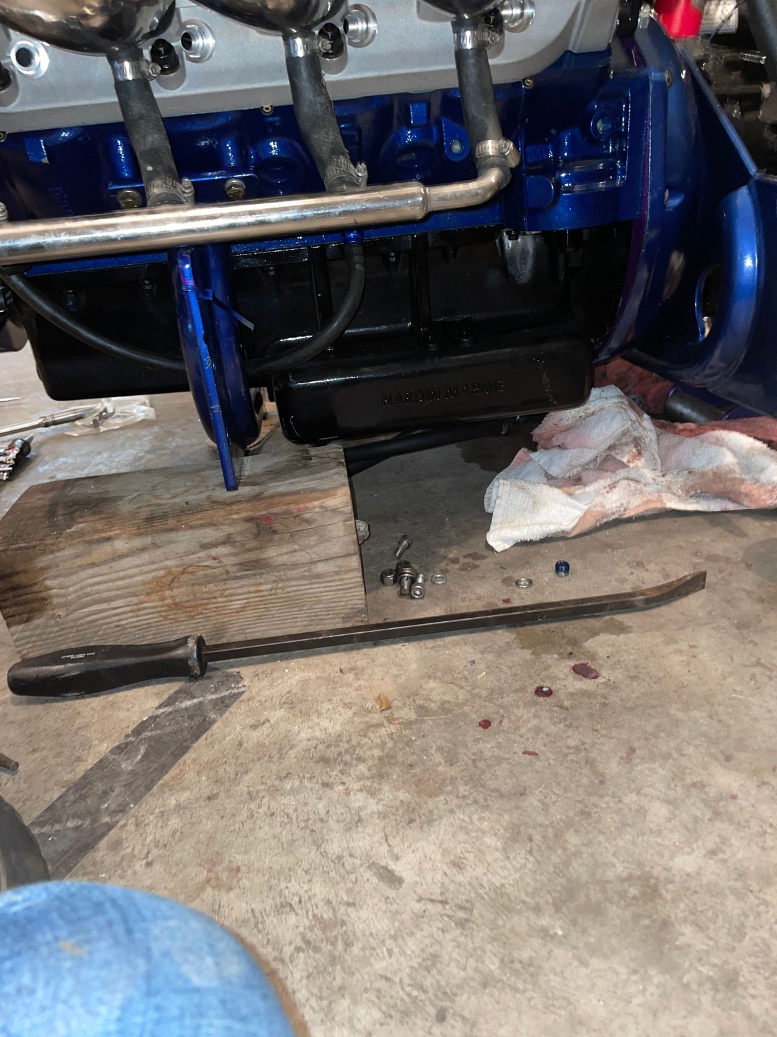

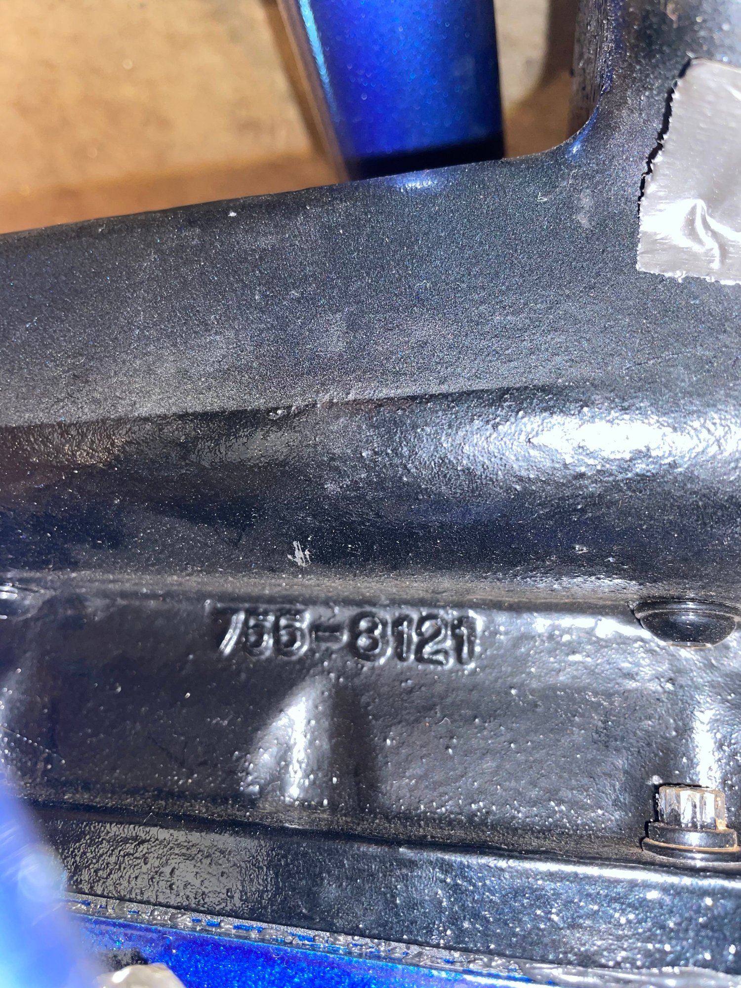

here’s a few pics with part number. If anyone can identify appreciate it. It has 2 - 1/4” pipe ports on left and 3 on the right. I rarely call tech support but did Hardin today and the guy was a complete jerk and rude and said it’s not one of their pans…. OK 😂
Does it look like a 10 or 12?
Told him I did purchase new from an OSO member which I did and then I got the whole oh you bought from some site on the internet! Don’t waste my time.
They may have been NOS #755-8121
number was upside down on the right side. Did a search on 755 and 766 etc and didn’t come up with anything.

That is an old eickert pan that Hardin Marine manufactured. They were discontinued back in 2014. It is a 10QT Gen 4 Pan.
