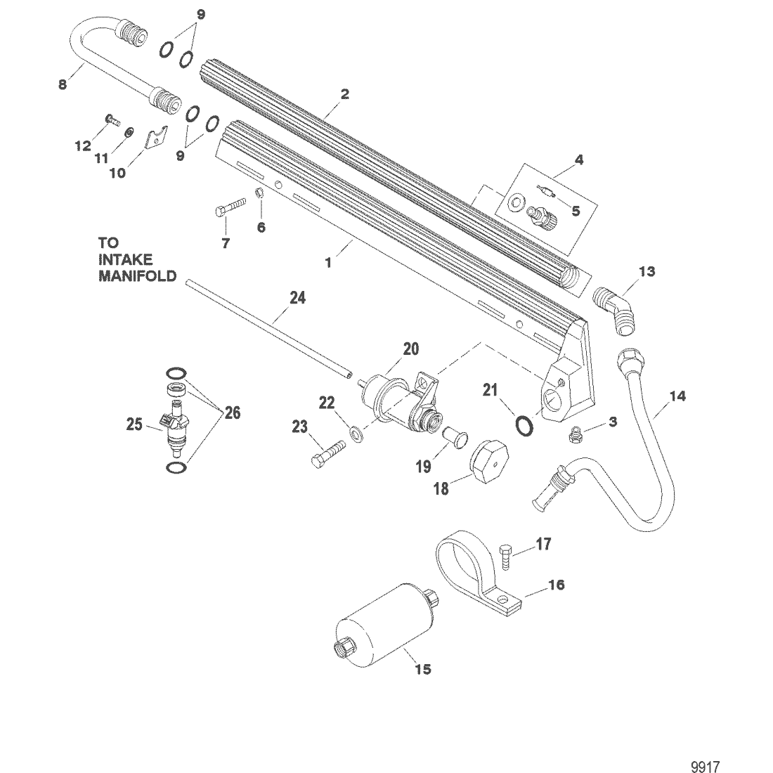

Originally Posted by SB (Post 4841827)
#4 is the schrader valve on your fuel rail for using a fuel psi checker. You can rent for free auto part stores like Autozone.
https://cimg4.ibsrv.net/gimg/www.off...6c9c6076ec.gif
I will check the pressure with a mechanical gauge to verify what it actually is. Thanks for the diagram

Wildman_grafix 08-17-2022 08:17 AM
15 is also a fuel filter, they need changed as well.
wieland77 08-17-2022 08:21 AM
I was told 15 is only a fuel "dampener" to give more of a consistent fuel flow. I can replace that next or would it be possible to somehow bypass to test if its faulty/plugged? I guess I could test it with the one off my other engine to test too.
SB 08-17-2022 08:26 AM
A fuel dampener is a regulator that’s not being used to adjust fuel psi.
#15 in below microfiche page is a fuel filter.
see:
https://www.mercruiserparts.com/bam/subassembly/31341/7595/110
#20 is a fuel dampener. It’s outlet is blocked off.
https://cimg0.ibsrv.net/gimg/www.off...dbd8439040.gif
