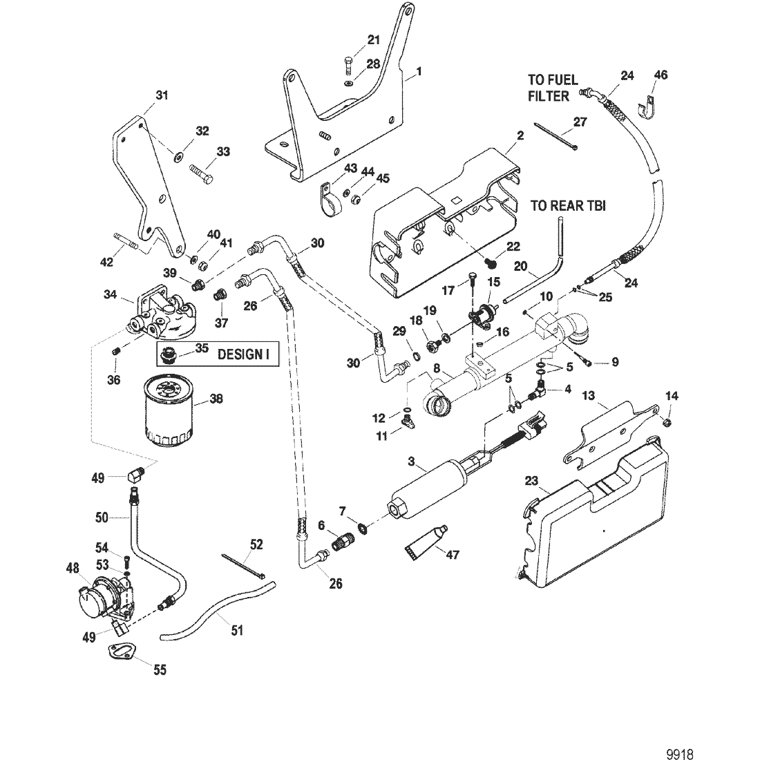

The actual regulator (one that set’s the psi) is #15 in this microfiche pic:

wieland77 08-17-2022 08:54 AM
Also see:
https://www.mercruiserparts.com/bam/...31341/7595/120
https://cimg5.ibsrv.net/gimg/www.off...ce88b5f96e.gif
right, I replaced that regulator as well as the elec fuel pump in the cool fuel system. How could the metal filter that as the back of fuel rail get plugged or fail?

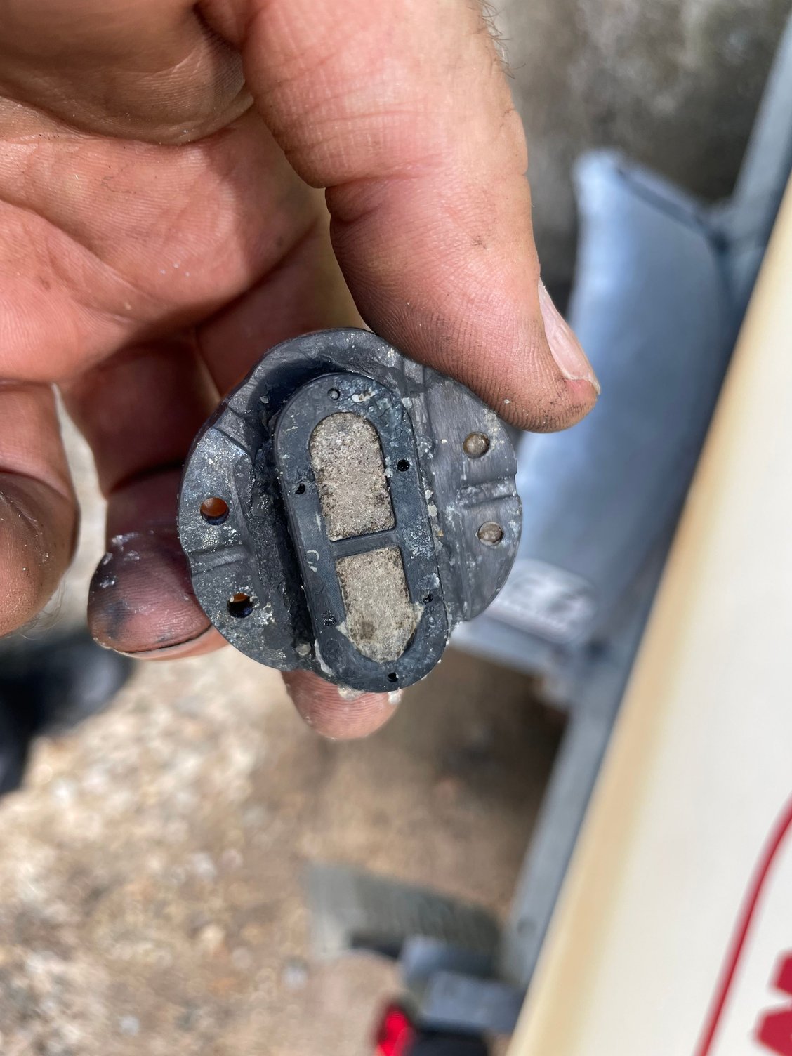

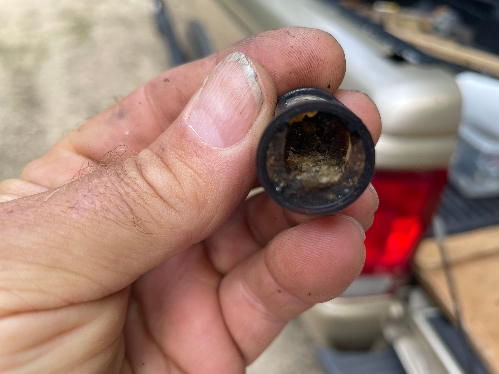

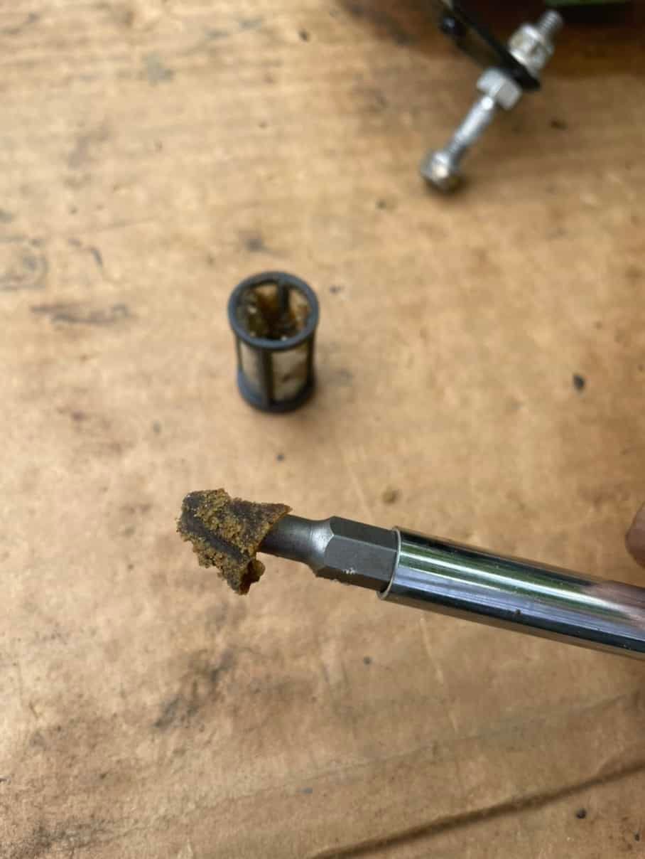

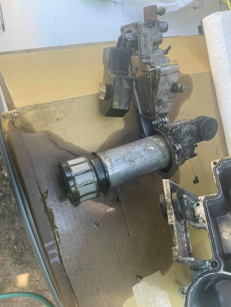

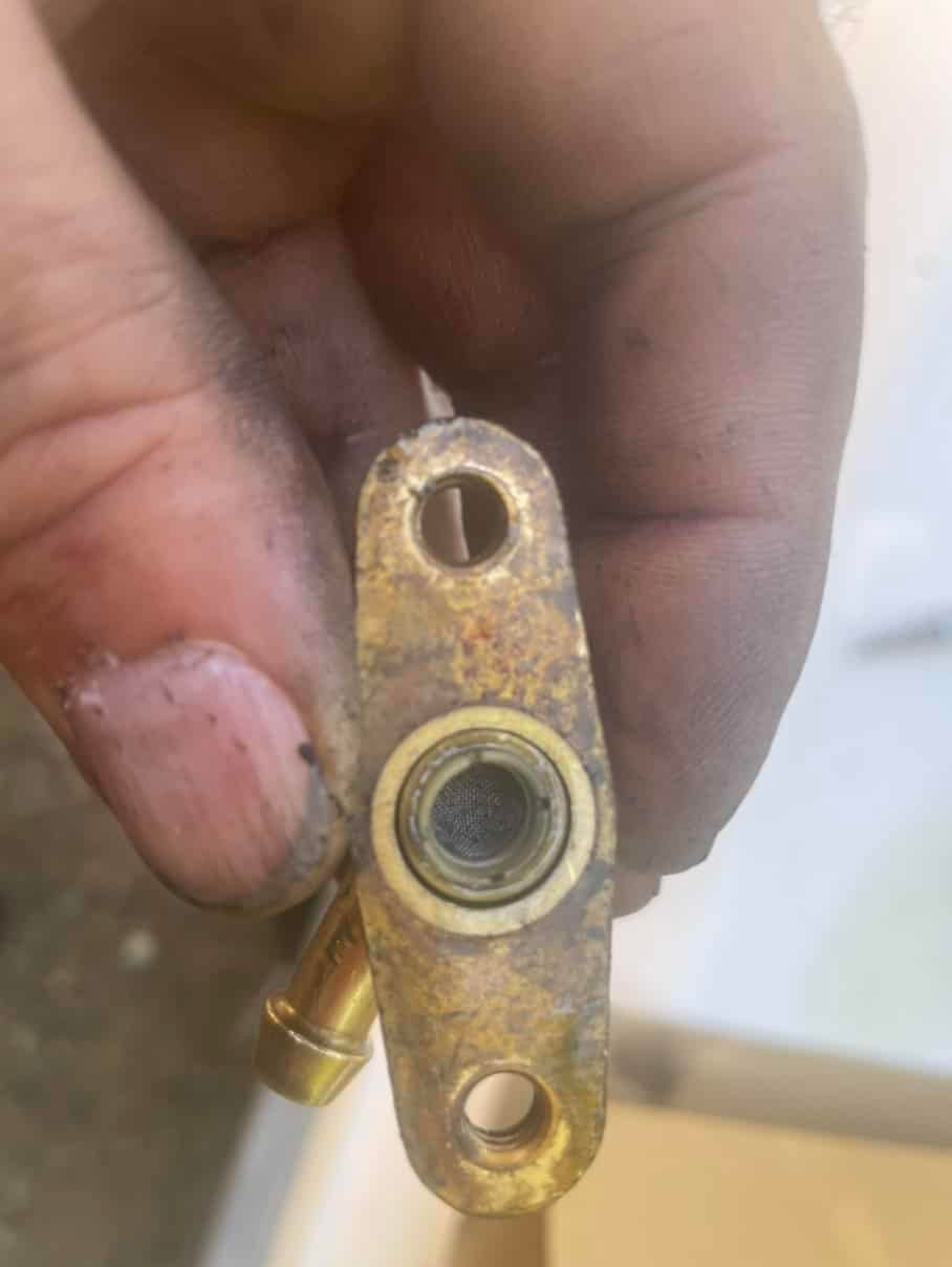

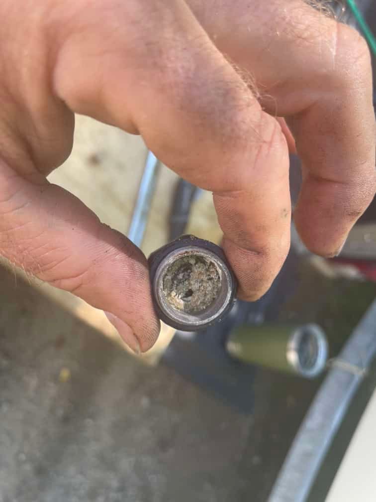

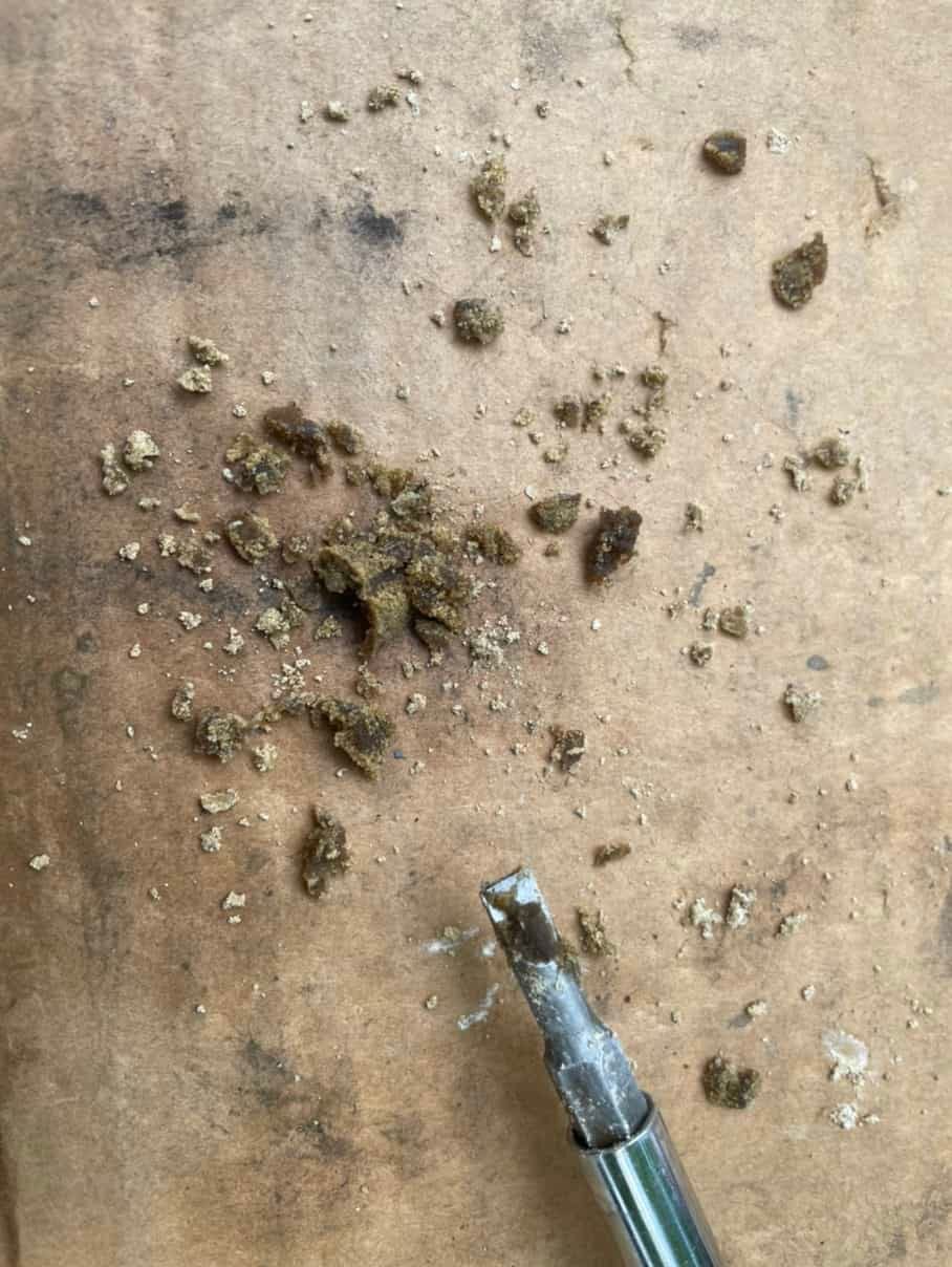

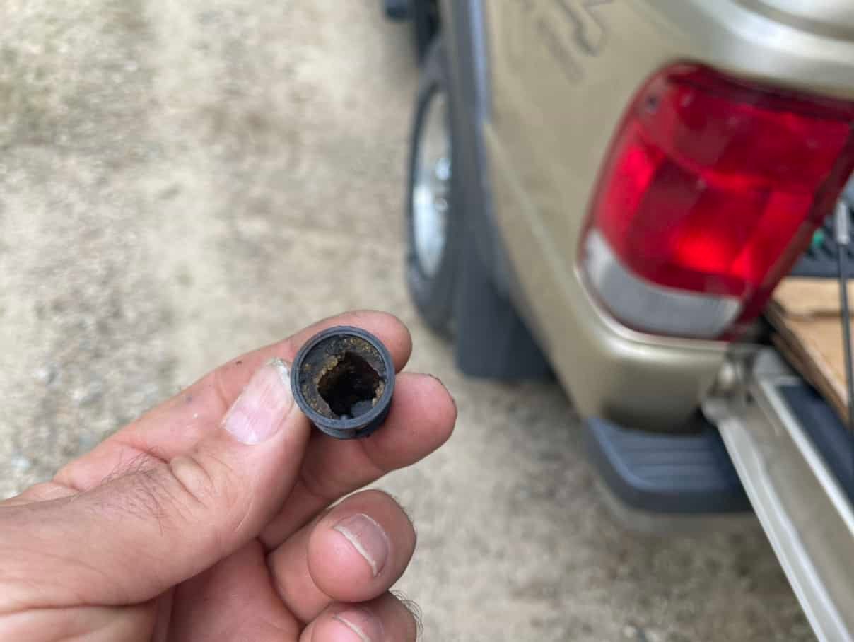

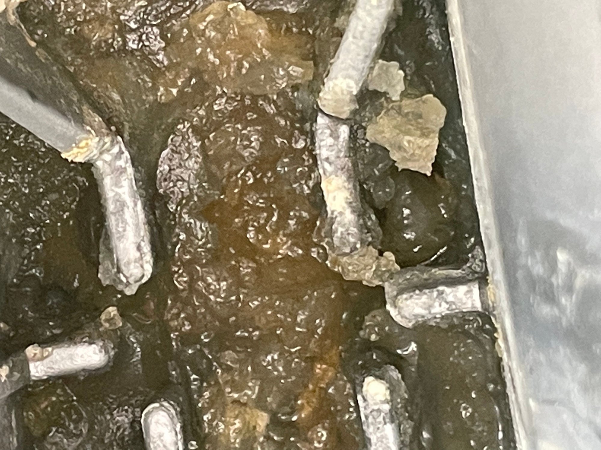

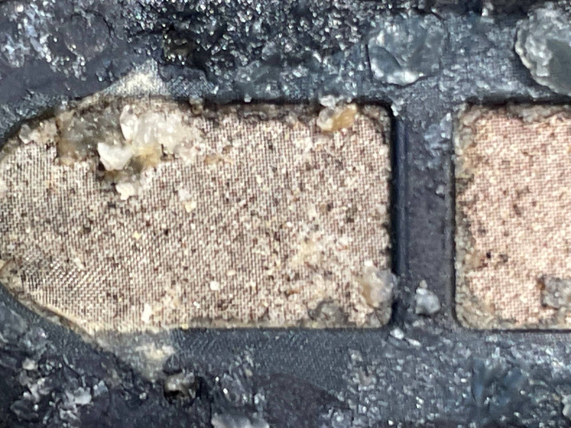

SB 08-17-2022 09:08 AM
How does a filter back there get plugged ? Debris after the fuel water seperator filter. From degrading fuel / fuel line / fuel pump/ fuel pump modules : etc.
You should see all the crap i find in filters after the sepetator filter. These pics from various fuel systems (4 different boats) just this year ;
