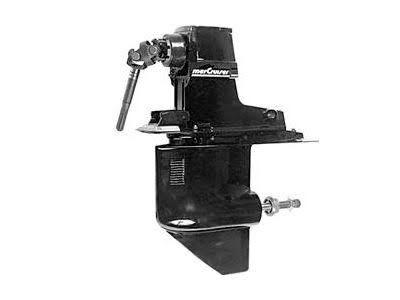

I can’t answer your question but to help clarify what you have, here’s the Bravo 1 and Bravo 2.
The Bravo 2 is the one with the straight/vertical trailing edge. It’s like an overweight commercial version of the sportier B1.
