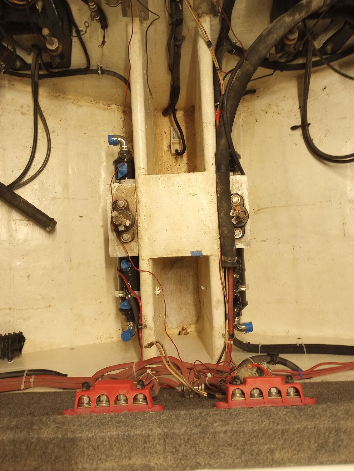

I have to go to the side instead of straight down as usual for rear engine mount bolts, but everything clears

I ended up installing my new coolers to the stringers below the engine mounts. They are from CP and have the power steering cooler included. 3"x23" supposed to be good from 450 to 750 hp. I'm at the low end of that but I figure better safe than sorry.

Nice setup! Compact and out of the way..I'm going to need the bigger plate cooler for my application but I plan to mount them in a very similar fashion.
