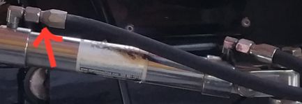

Hi, does somebody know from where to source stainless fittings to M&M hydraulic steering? Any shops to get these from south FL, between Miami - Ft Lauderdale? Thanks

I had new hoses made for mine - Parker. They were expensive.
Could always check with Sick Stinger. He might have some hoses where you can salvage the fittings. You'll need the proper mandrel to attach the fitting to the hose.

The MM fittings are not Stainless. They are SS or nickle plated brass. Brass seals better. They are also reuseable and I reused mine. Kind of a pain to get the old hose out, but applying some heat helps. You don't need any special tools. The hose literally screws onto the inner part of the fitting.
CP only sells the brass -6 JIC ones. Teague sells the SS fittings which are an IMCO part https://teaguecustommarine.com/hyd-s...parts-fittings

Good info, thank you. I was stupid enough to throw the old ones away since they had some corrosion..

I ordered my hoses with fittings attached from Latham last year and also ordered the #6 90 degree fittings from CP. I sent the 90's to a local plating shop and had them chrome plated. Feel free to message me if you need any info.
