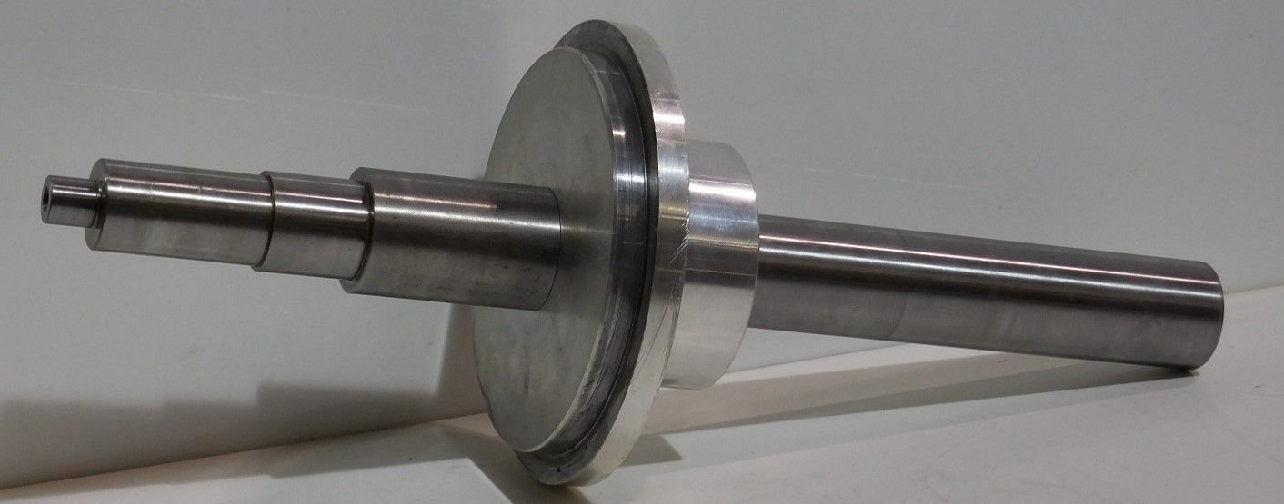

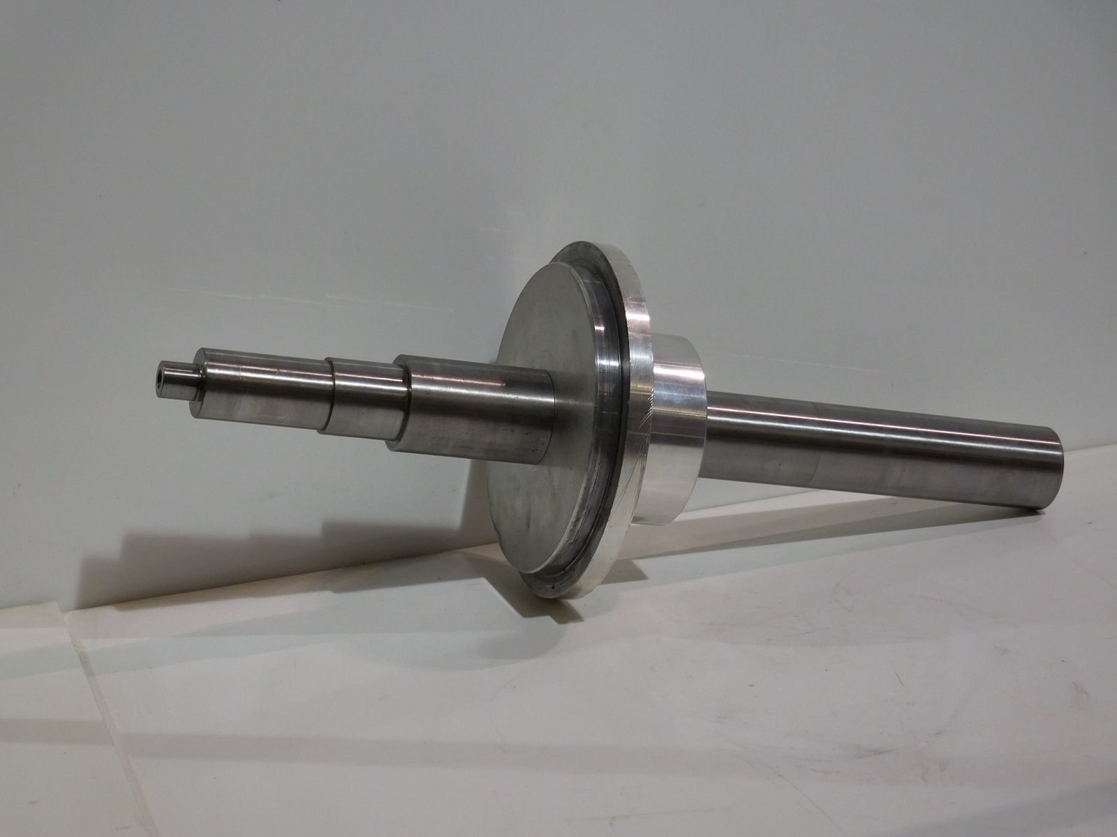

Here is one we have made

Here is one we have made in the past. We lend it out with our NEXT transmission kit.
I'll see if I can find the drawing.

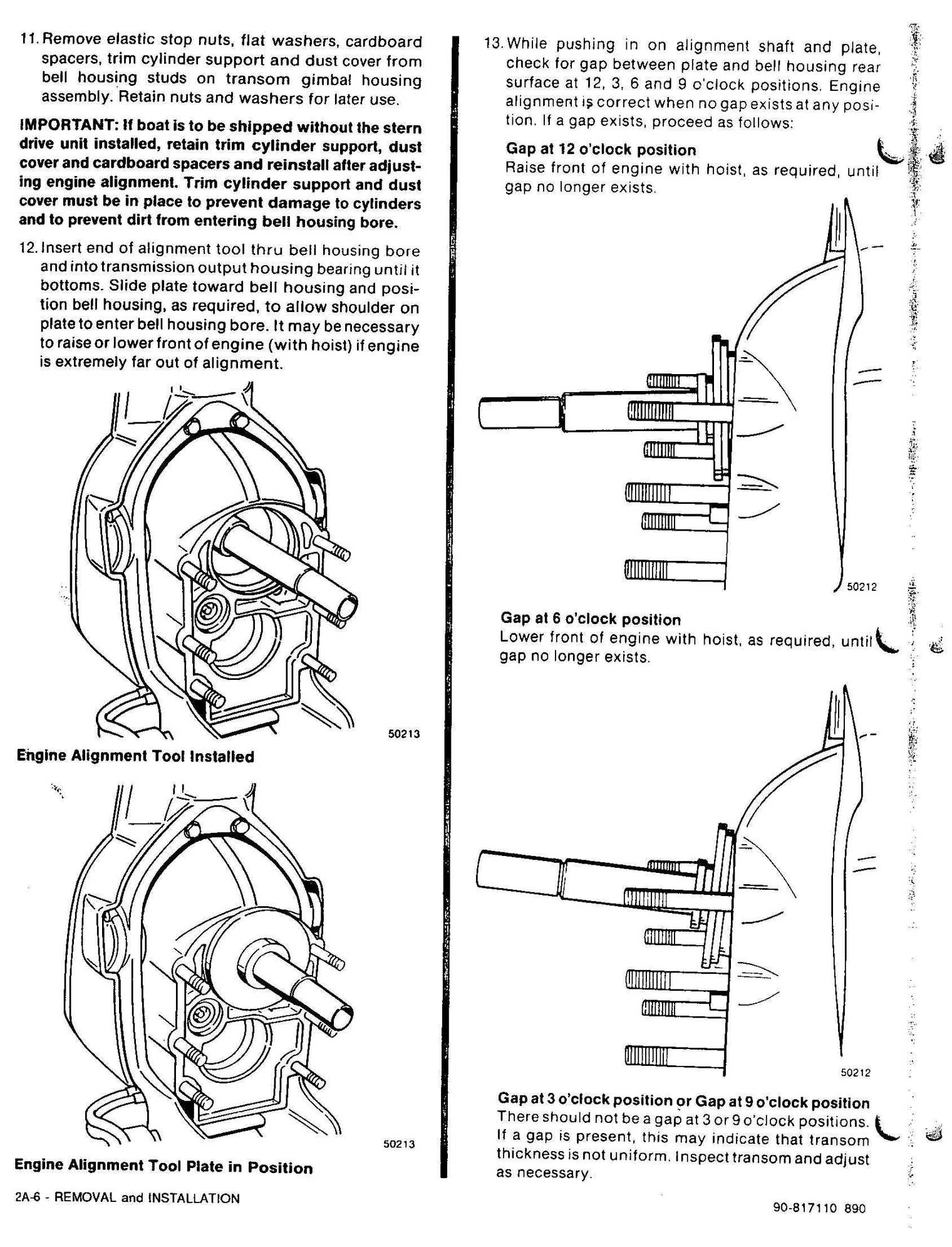

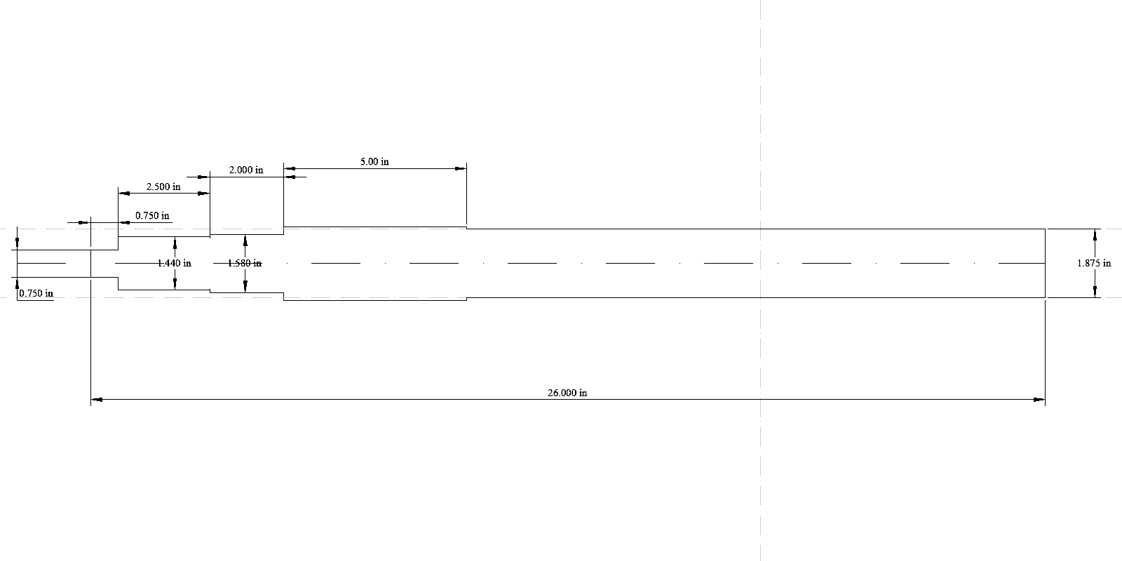

I can't find the drawing for the disc. Just measure the ID of the bell housing. Also I can't remember what that 5" long section of the tool is for. I don't think it has to be there.
Hopefully you can find someone to make the tool for you quickly.
Mercury doesn't really have a tool for the M6/NXT so the instructions are out of an old shop manual (which is where I got the idea in the first place)

was that schematic for the tool?
intimid8 is offline
Old 12-17-2022 | 11:07 AM
Mbam's Avatar
Offshoreonly Advertiser
Joined: Mar 2001
Posts: 2,518
Likes: 284
From: Pompano Beach FL, USA
Yes
