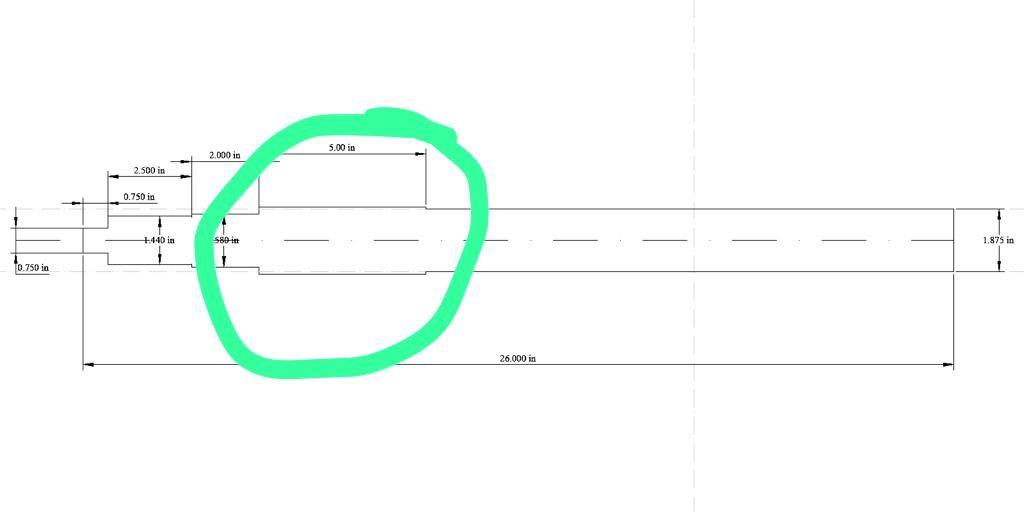

Old 12-18-2022 | 03:09 AM
Joined: Jan 2012
Posts: 204
Originally Posted by Mbam
I can't find the drawing for the disc. Just measure the ID of the bell housing. Also I can't remember what that 5" long section of the tool is for. I don't think it has to be there.
Hopefully you can find someone to make the tool for you quickly.
Mercury doesn't really have a tool for the M6/NXT so the instructions are out of an old shop manual (which is where I got the idea in the first place)
would you know what the od is on that specific section.
it seems there is a step up

Old 12-18-2022 | 07:21 AM
Joined: Jul 2007
Posts: 3,337
Likes: 860
If his cad drawing is correct to scale it looks like 2" OD

Old 12-18-2022 | 07:55 AM
Joined: Jul 2009
Posts: 8,527
Likes: 706
From: Taunton Ma
https://www.hardin-marine.com/p-6217...899898t05.aspx
this is the one I bought for 6’s

Old 12-18-2022 | 10:57 AM
Mbam's Avatar
Offshoreonly Advertiser
Joined: Mar 2001
Posts: 2,518
Likes: 284
From: Pompano Beach FL, USA
I'm pretty sure that part of the drawing is a mistake. I will verify when I get to the shop later in the week.. When I made that Mercury didn't have a tool.
That Mercury part number looks like it will do the job. There are 6 pieces at the factory. I'm sure it's less expensive to buy that one.
We are closed until Jan 3 so you can get it faster from another dealer.

Old 12-18-2022 | 06:43 PM
Joined: Mar 2011
Posts: 943
Likes: 277
From: So. Burl. VT.
That's what we did made ours out of delrin.
