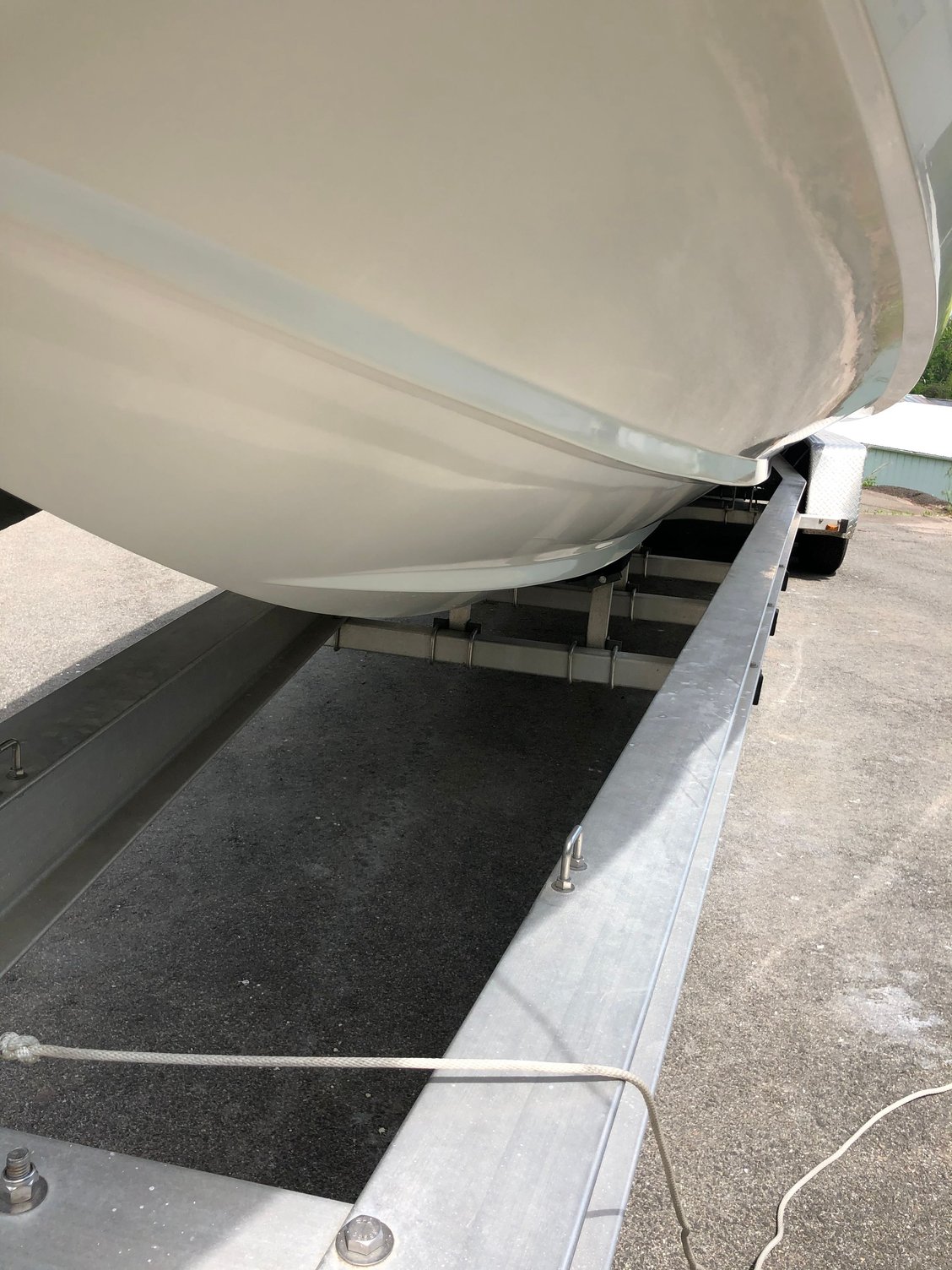

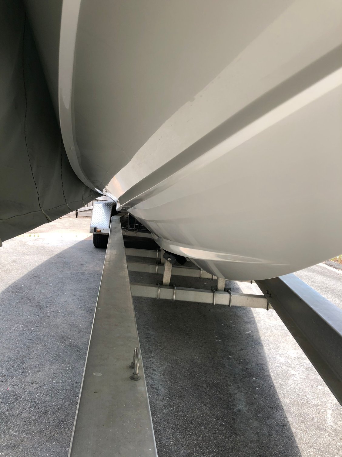

Need to clean the bottom of the Baja. Even after using muriatic acid it feels like it's not clean. There seems to be some debate about what's best for the bottom. Some say polish and wax. Other say sand the last couple feet that are in the water at high speed. Some say sand across the bottom, some say sand with direction of flow. With all those options, I was thinking about a hydrophobic coating.
What is the real gain from sanding on a boat that currently runs 70+ with plans to double the hp.
Polish and wax or hydrophobic would probably stay the cleanest. But I'm intrigued with the sanding. It supposedly breaks up the "suction" of the water on the bottom of the boat. Wouldn't a hydrophobic coating do the same thing considering water is repelled from contact with it?
Opinions please.
