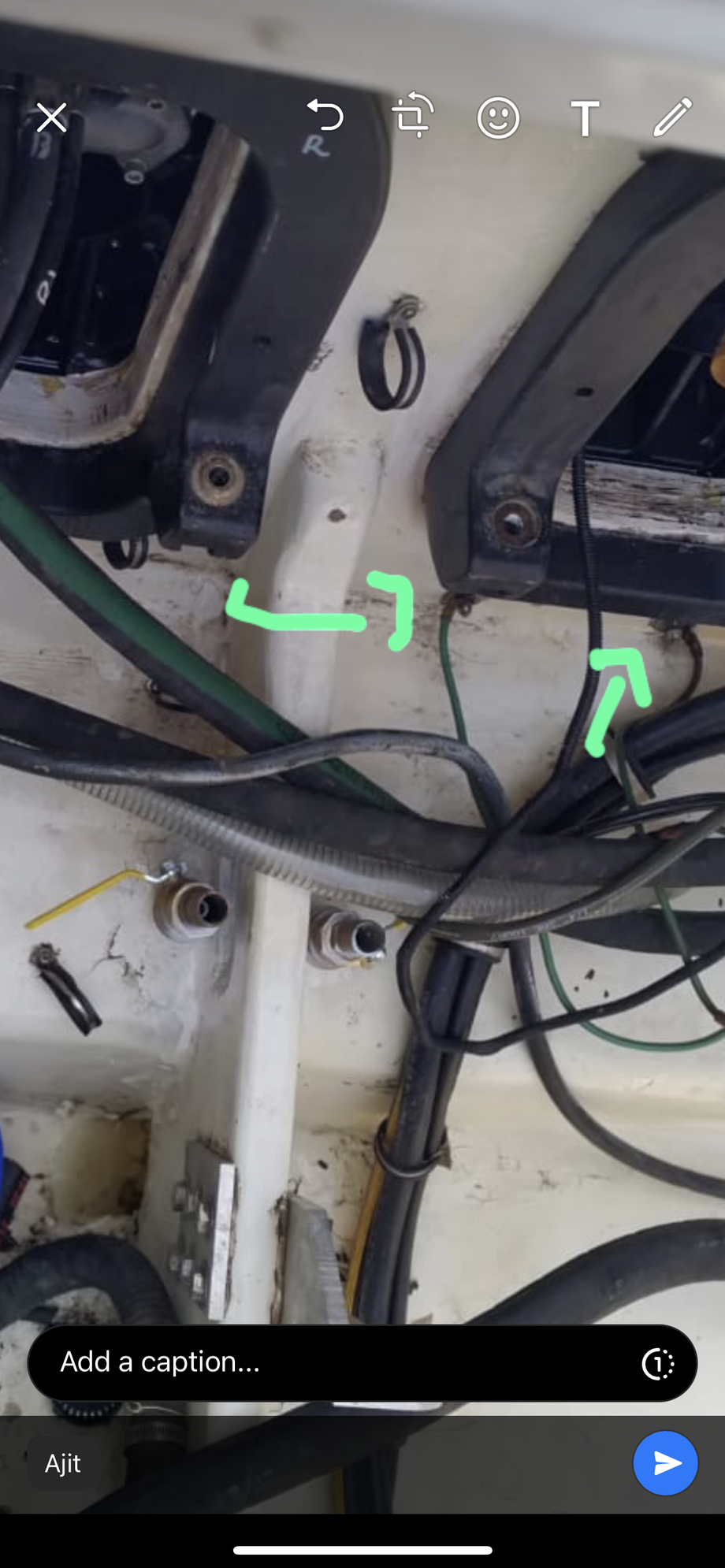

Hey guys
so I’m trying to put my engines back in my donzi unfortunately the guy who took them out is no longer in contact and I’m trying to figure out how to put this thing together.
I have two bolts with green wires under one transom assembly (port side) which is also the forward engine on the staggered. I believe they are grounds but I am not quite sure why donzi would put them on one side rather than both if they were.
if anyone could help me would appreciate it
thanks

They are bonding wires for galvanic corrosion. Many manufacturers do not install them if the unit is grounded directly to the battery, like an outboard or a close couple I/o.
