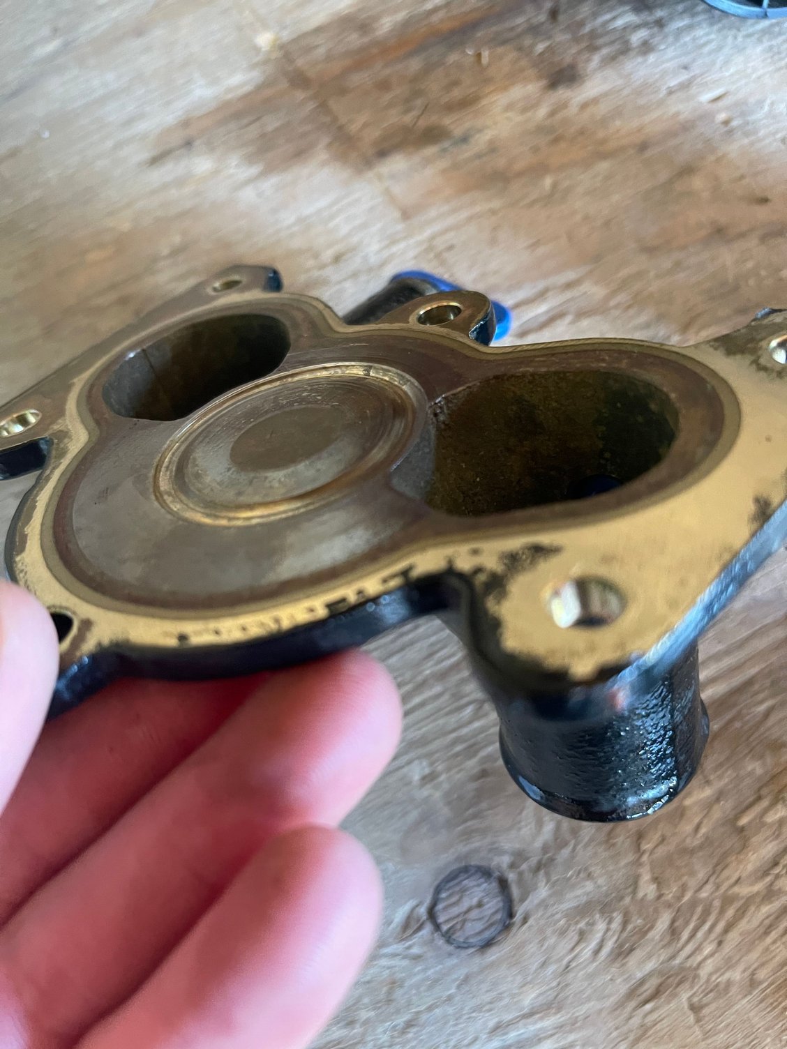

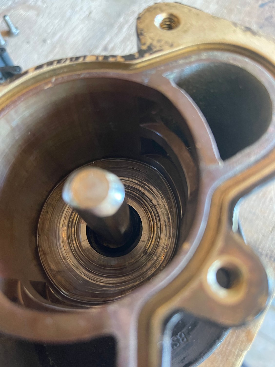

i have read on sea water pump and i have come to the conclusion that i am not the only one having problem with pumping water with the external hose … i had to hit the throttle to get it to pump effectively… maybe my old pump was so bad that it did not help … plus my bearing totally busted with water leaking from pulley …
That housing is junk. That's why you were having issues.
The Hardin will take care of the wear issue with the replaceable plates.
underpsi68 is offline
My question is since its going to be assembled already by factory do you know if they lube the housing to prevent wear for the first start up ?
If you aren't aware they are what I call, sort of partially assembled.
You have to reuse your backplate where the hoses connect, and they have a stainless wear plate that goes in between the pump and your worn back plate.
I agree.
But on the contrary mine are in the same shape as his and have been pumping water fine the past 6 years.
I've had the Hardins since and just getting around to installing them for this season.
I did some bearings and seals in one of my OEM pumps, while I was waiting on the Hardins.
Got it going and put Hardins on shelf.
New impellers every other year.
Figured this year throw them on.
cheech is offline
