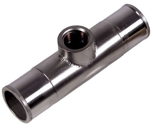

Why can’t you do it off the bravo pump. T with say a 5-10psi regulator do it doesn’t cool off at idle. ?
SB is offline
Old 05-03-2023 | 09:19 PM
SB
Joined: Nov 2004
Posts: 14,152
Likes: 3,712
From: On A Dirt Floor
https://www.cpperformance.com/p-977-...se-12-npt.aspx
SB is offline
