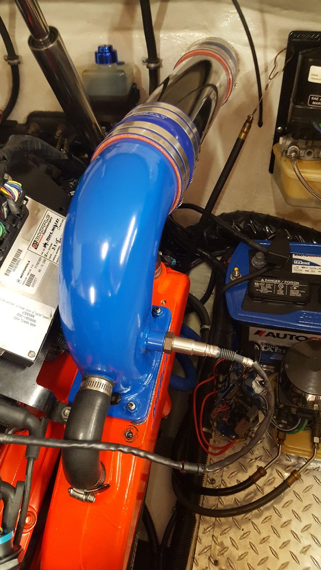

Exhaust risers are dry to transom.

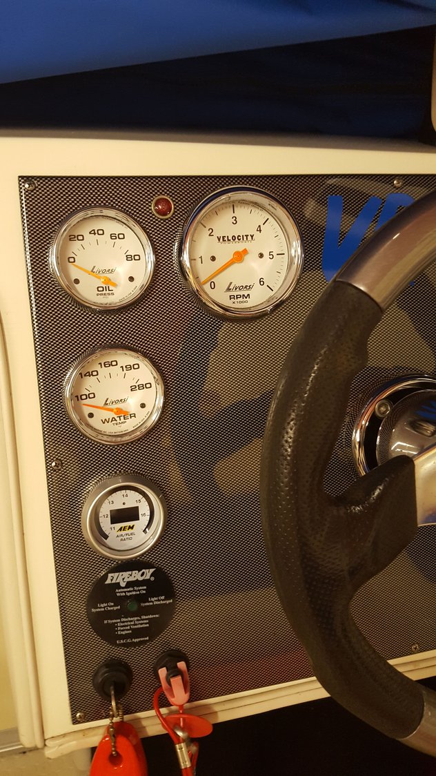

AEM Uego kit Installed in 2019. Sensor never came out of riser and I monitor af/r while engine is running. I have power to gauge/sensor wired off a rocker switch on dash. AEM states to never operate engine without power on gauge/sensor.
I have read others opinion to not power up sensor before starting engine. Idea is a hot sensor porcelain is hit by cold engine start condensation and slowly damages sensor?
My gauge started showing full lean yesterday. Will replace sensor today. From reading online it seems I got my moneys worth from sensor?
What's everyone else's experience?

Moisture in some boat exhaust kills sensors faster then in cars, two years is pretty good though, I use these Innovate directional HBX-1 3729 protectors when tuning customers boats on water, the sensors last alot longer:
